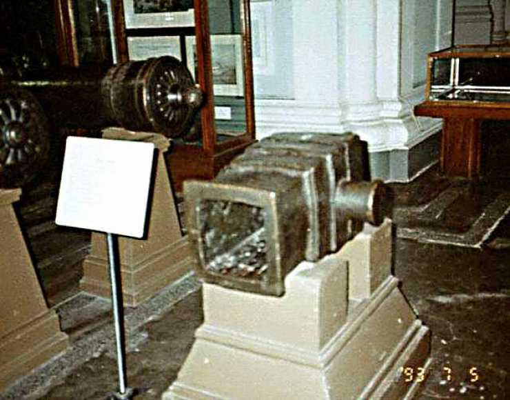

Have any of the master machinists here ever considered doing a rectangular bore?  We end up with all these GOEX cans...

Yo! subdjoe. Here's your GOEX cannon. It's from the Mary Rose.  Sorry for all the copy but this HP is a tird compared to my old Lexmark when it comes to editing.

Yes, the Murderer!  It fired cubes.
Gonna take out my set of square cross-section drill bits and build one today!
Actually it would have some advantages as far as projectiles, you could just take appropriate square cross-section bar stock, set the length stop appropriately, and run it through the bandsaw.

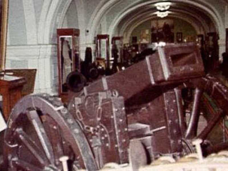

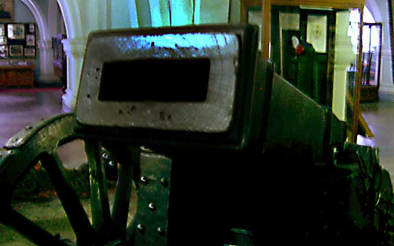

This 18th century rectangular bore cannon is at the St. Petersburg Artillery Museum in Russia. It was designed to fire grape shot, and supposedly disperse the shot over a larger horizontal area.

Boomj that rectangular bore job looks like a great project for someone !
for something kinda squarish they sure did a nice job ! nice lines , and proly real scary to face ..... :o
gary
Gary,
I'll go along with Cannonmn's night watchman wish; I'd consider it a great vacation to have about a week, and be given free rein to wander anywhere I wished in (and outside-there are tons of bronze guns and mortars lined up in rows outdoors) this Russian museum, equiped with nothing more than a good quality digital video camera.

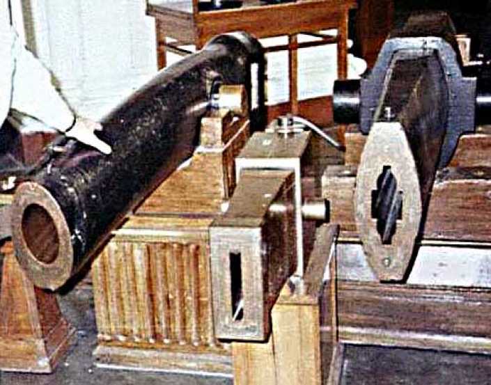

Here is another photo of some more experimental cannons at this museum: I'm a little lost on the intended function of these guns; I suppose these disc guns might have been intended to fire at the ground to roll, and bowl over troops and horses.
"Experimental weapons shooting disk projectiles, left to right a. Mayevskii cannon barrel, b. Plestosov and Myasoyedov cannon barrel, c. Andrianovo cannon barrel - all in the main hall of the Artillery Museum."

 Looks like the picture's squished.
 I like the one in the middle. I'd turn it on its side and use it as a frizbee cannon :)
 There we go....  We can add a tennis ball cannon and we can corner the pet market too....  :D :D It's all in the name of fun... muh ha ha!!!!
