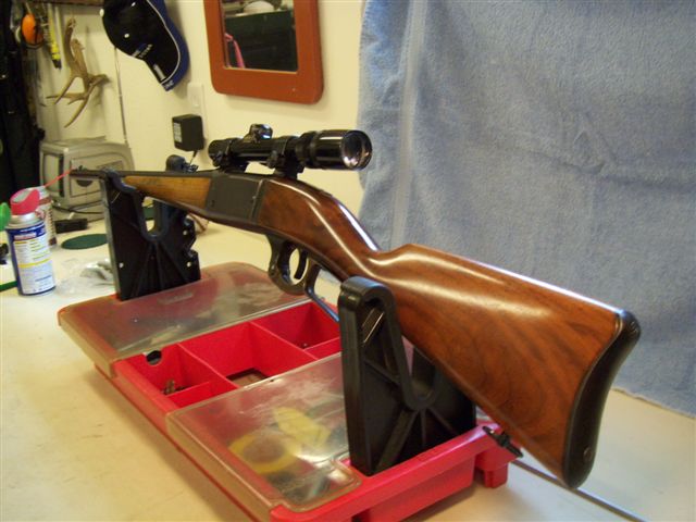

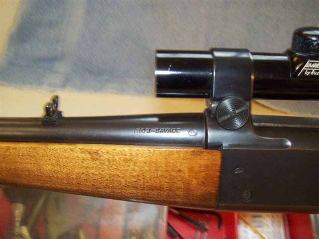

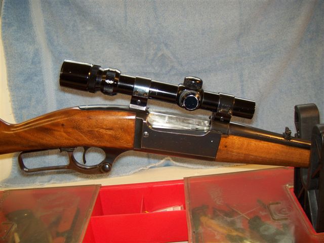

Hey Guys,
Have a neat 99 .303 carbine.  Two questions.  I don't want to spend a fortune for a scope.  I has an old variable that's not too great but has a straight tube with no bell on the front objective.
1.  I there a reasonalby priced scope to replace this one with a straight tube?  Could be a low power variable or fixed.  I would like to shoot a deer this season with it and it is a .30-30 class gun so 150 yds. would be the outside range.  What would you recommend?
My brass seems to have a case of split necks quite frequently.  I have the same problem with my .250 -3000.  This occurs even with once fired brass at times.  It is prety subtle so you don't see it easily until after cases have been resized.  It has occured in the .303 using once fire brass with loads from a commercial reloader.  It has occured in the .250 using old WW factory loads.  The brass in this case was probably as old as me (very old) and that could be the problem.
2.  Has anyone experienced this problem with their brass in the 99?  I this an inherent problem with the 99 due to the type of action and headspace?  Do you anneal your brass?  What are you pet loads for your .303?
I guess that was six questions!
Thanks,
Blowtorch

Scopes. This cartridge is in the .30/30 class. I wouldn't get to excited looking for a scope much over 4x. Many of the old, low power variables had straight front. They didn't need to collect all that much light for the low power lens system. You can mount lower and have a more handy rifle. But you have to be happy. Hit the web sites and look at the options. Many less expensive that should stand up to .30/30 cartridge and get the job done. Midway.com. Grafs.com, Wideners.com, MIdsouthshooterssupply.com, etc.
It kinda sounds like it is the age of your cases that makes for the necks cracking. One batch of surplus military was sold with cracked necks. Seems the necks were not annealed just right for that brass. I would try some new brass (yes, a bit difficult for the .303 Savage) before making this a final conclusion.
You can anneal necks. The easiest way, melt pure lead, muzzled loader balls if necessary, and take the UNPRIMED CASE by your fingers, and dip the neck into the liquid lead for the area of the neck you want annealled. When it is too hot to handle, drop into water, bucket, whatever... Luck.

   Weaver started remaking the K series scopes a few years ago, calling them the "Classic K."   They come in fixed 3 power andr 4 power.  I think I paid about $150 for mine.  They are a great value, built like tanks. Lots of eye relief.  Very clear.  No bell on the front.   I would highly recommend one for this rifle.

   Since you now have an f model in 308 I'd leave the old clasic scope on the 303!  Just clean it up!  I have a 99f in 308 it shoots great, will handle anything I want to hunt and wears a 2x7 Leupold.  The combo will handle anything from 15 yrds to 40yrds.  I think the only thing that comes close is the 300 Sav if you hand load.  The 300 Sav will approach 30-06 stats if you roll your own.
