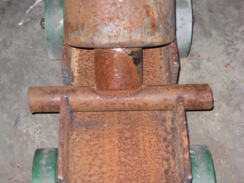

« on: April 28, 2009, 04:25:31 PM »
Victor, I think I have caught the bug. This is my new project.

You carriage looks to small and unstable with the angle of the barrel.  Wheel won't help.  If you search the board for Bill Tyrrell's Floridia bowling ball mortar.  He had a similiar configuration for the base and his mortar would flip on its back.

Your carriage looks too small and unstable with the angle of the barrel.  Wheels won't help.
I had similar thoughts when I first viewed this piece.  The wheels are an interesting variation.  It is my opinion that if fired on a smooth hard surface, the wheels will prevent the piece from falling over backwards because there will be no force that can be applied to the bottom of the carriage that would form a couple.  However, if the wheels are not free to roll, the axis of the bore appears to be behind the axis of the axle which might cause the piece to flip over.  One way to fix this is to make the barrel closer to vertical or tip it over and face it the other direction.

It is still under construction. I plan to take 6 to 8 inches off the barrel length. I just put it on to get a feel for how it was going to look. It has a long way to go before I can fire it. Until then, I am still content shooting golf balls. Nitrosteel has managed over 700 yards with his. He shoots from one end of the farm to the other.

Rule of thumb length for mortar Barrel length shall not exceed 2 times the projectile length, while projectile length shall not exceed 3 times the bore diameter.
The chamber walls should be no lees than the diameter of the chamber in a mortar.
George could be right about the wheels working to prevent rear tip.  I think recoil impluse will be to fast for the wheel to compensate.  The rear extension need to be longer.

Bornsouthern34
Is that base a huge I beam ?  Looks stout .
What do you have for powder chamber ?
How are the trunions fastened to the base ?

If you guys go to the sticky at the top of the forum for safe loads and cannon plans an look over the list of Mortar links there you will find some base ideas.

Yes, it is a section of 12" I-beam. Very stout. Powder chamber is 4" round stock with the trunion welded to the base of the powder chamber. Looks bad because I left it in the rain in the back of my truck for about 3 weeks. Bad on me. Anyway, it will look better when I get it cleaned up and painted. As for elevation, none yet. I figured on adjusting the powder charge only but if any of you have any better suggestions please comment.
Double D,
After I cut 6 inches off the barrel, it will be exactly 2 times the length of a bowling ball and end precisely at the front of the carriage. Thoughts?

My bad, the I beam is 10". Also, the wheels are from 1000 lb casters off a big rolling tool box.
Again, it is still a work in progress. I will not permanantly mount the barrel until I get it cut down to a more appropriate size. My friend is getting 600 to 700 yards with a bowling ball out of his and they are almost identical.
At that point you may be able to flop the barrel over the opposite direction and eliminate the stability problem.  Do you plan to put some kind of "capsquares" above the trunnion?

I have not capped the trunion yet because I need to cut the barrel. I am still in limbo on whether or not to try and put some type of screw for elevation. As for shooting, we launch across a 100+ acre cattle farm. We also have permission to be on the adjacent wooded property if necessary.

What are the dimensions of the powder chamber?
Carronader the only part of his gun that holds powder is the little tiny chamber down in the bottom.   The bowling ball sits on top of it. the larger visable barrel is little more than an expansion chamber and projector barrel for ball.

Powder chamber is cut from 4" round stock that is 6" long. As you can see though, the diameter of the chamber is 2" with a 1" wall thickness which is more than the recomended 1" to 1" rule. With that in mind, I do not plan on ever shooting it with a full load of powder.

No the wall thicknes rule of thumb is the wall should be the same thickens as the diameter of the bore.  Bore in a mortar being the powder chamber.  If you have a two inch diameter powder chamber you need the walls to be 2 inch thick also.  2 inch chamber your minimum safe recommended diameter would be 6 inches.
If your chamber is 6 inches long then that means with a 2 inch chamber the depth of you chamber is 4 inches.

I think we are on the same page. I just read backwards sometimes. ;D  Yes, it was my understanding as you wrote it, for some reason I am unable to convey that correctly. On mine I have a 1" wall with 2" bore. It should be 2" walls because of a 2" bore.
A test fire last night showed that I am going to have to use real BP or convert to percussion cap instead of fuse. Triple seven did not shoot good at all. We got 500+ yards out of Nitrosteels but he uses a 209 primer for ignition.
My dad said they used to put a very small amount of FFFF in the fuse hole to help with ignition. Thoughts?

No we aren't on the same page. Bore 2 inch, wall 2 inch all the way around the bore.   Diameter is wall plus bore plus wall.  2 inch wall plus 2 inch bore  plus 2 inch equal 6 inch diameter.
FFFFG will work, but you might want to take alook at the post on making quill.  Much more efficient, and fun.

Big Bangs are in my blood. As for the welds, they are stair stepped out from the chamber. Just a conservative guess, but I would say 3 high by 3 or 4 wide with good penetration.

I ASSUME that the 4130 was preheated before welding to the recommended temp.
