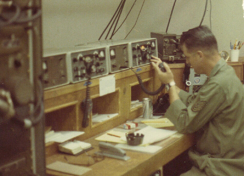

Thanks NS4M    Rick:
  Here is a pic calling in an air-strike north of DaNang City,VN.. in '68'.    Our guys stayed busy 24/7/365.  Ground Troops called us for air support requesting specific ordnance.   Our Operations crew in turn called the air base on the red phone (hot line).   Once airborne, the fighters would request grids and radio frequencies.   Then we'd monitor the events between ground and air as they developed.   All ammo dispensed via fighterbombers, destructions, casualties, both livestock and human were collected and radio'd to us for compilation.  I then  secret coded it and sent it to higher echelons.   Even in heavy downpours, we'd call in the Navy A6's {I think that was what they were} with their super nose cone radar equipment to do what was necessary.  I got some real fast OJT on one of these radio's once {which was highly out of the norm} when an airborne FAC Pilot requested to talk to me.
We had some world-wide radios over to the right out of the picture.    Our Commander liked to catch up with things in the Philippines from time to time.

« Reply #7 on: April 25, 2009, 07:31:58 PM »
4b, that nam shack is all collins s-line gear. worth a pretty penny then and a prettier penny now. that gear was for a guy that knew how to  tune a transmitter.( not much to it if you think a little!!).the old rigs are almost a hobby unto them selves now. drake gear has a following.collins. heathkit of course. a lot of guys like the even older stuff like johnson, hallicraters, hammarlund, national etc. just about any of the modern off the shelf radios will give outstanding service. for me it comes down to custormer service.yaesu has always went just alittle extra for me. that is why i lean towards them for off the shelf stuff. if i ever get rich, famous , and goodlookin i would consider one of the new elecraft k3 hf kit radios. supposed to have a better reciever than the ten tec orion2.but for now i will just have to stick with a yaesu ft-one on hf and the 2800m for 2mtrs.ahhh to  have your problem, money and wants for a new radio!!!!like i said 4b you ain't gonna notice a whole lot of difference in any modern jap radio. good luck with the test. if i can help you out any give me a shout.take care. lokking forward to hearing you on the air.73's aa5ez qrt sk.
