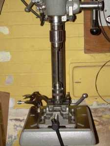

If it IS chambered and you need to reduce the barrel OD without a lathe, it CAN be done with a decent size drill press as long as the distance between the press chuck and the baseplate is at least an inch longer than your barrel.  In about 2 hours and $15 in specialized tooling, you can turn most drill presses into a rudimentary vertical lathe.  I've turned a couple shorter barrels this way.  Of course, you can't thread  but you can do basic turning.
Tool list: Drill press. Plumb bob with string. All thread with lock nuts.  Electrical tape.  1 fired case. Assorted drill bits. Bearing/race with ID size of all thread.  Decent calipers.  Large metal file.  Hacksaw. Imagination.
See if you can figure it out.
When I do my next one, I'll take photos if someone more experienced here knows how to post them.
I've not yet done any barrel work but I've considered it.
Here's a pic for illustration of a method I've used on smaller stuff for having my drill press function as an improvised vertical lathe:
