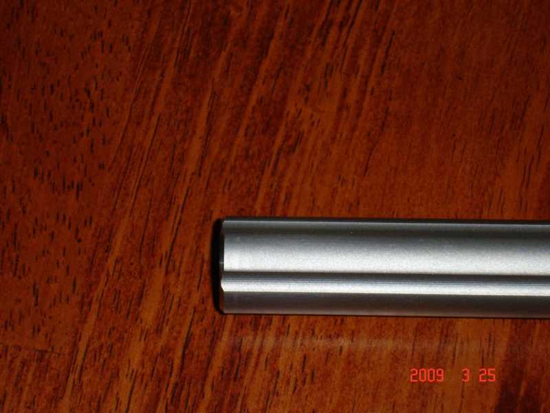

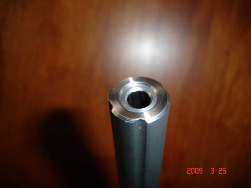

Offline JTD305
  • Posts: 76
Re: Shortened Barrel
« Reply #20 on: March 25, 2009, 08:42:48 AM »
I received my barrel from my smith today and he did a great job with the flutes and the crown is much better than the factory crown.  I don't know how to post pics, but you can e-mail me @ jtd0314@ne.rr.com for pics.  :-*

Offline hogrdr
  • Posts: 201
« Reply #24 on: March 26, 2009, 06:45:35 AM »
Thanks for pictures IMHO I think the Pro Hunter barrel looks fine shortened into flutes. All the talk of how stupid they would look had me wondering but I think it looks great!
Hog

Offline hogrdr
  • Posts: 201
« Reply #26 on: March 27, 2009, 08:32:32 AM »
Hope JTD305 is ok with me posting these pictures of his cut down P/H barrel as I think it looks nice!
Offline Keith L
  • Posts: 3781
« Reply #27 on: March 27, 2009, 10:04:19 AM »
That looks outstanding.  I would like to see it on the frame.
