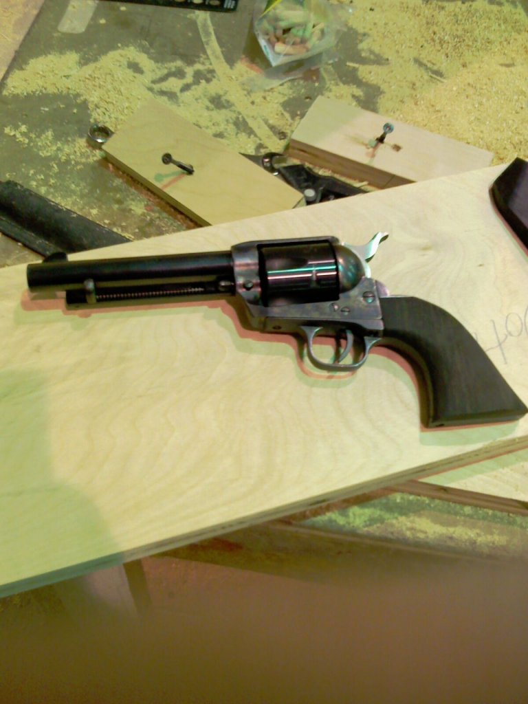

Okay I bit the bullet (no pun intended) and bought it. It is a colt cowboy cb1850. It's a colt saa copy made by colt? The shop I got it from didn't have much info for me. Is there anything you guys think I should be aware of? It is a smokeless frame with a transfer bar system. I haven't fired a shot yet and I am already hooked. It points so naturally I keep playing with it. The trigger is a little heavy though.

To get the most from your saa you will want to remove the tie strap that is holding the hammer down.
Offline Bart Solo
  • Posts: 706
Re: colt saa
« Reply #6 on: February 23, 2009, 02:19:10 AM »
Nice looking shooter.  I too would get rid of that plastic tie. I don't think it is original equipment.

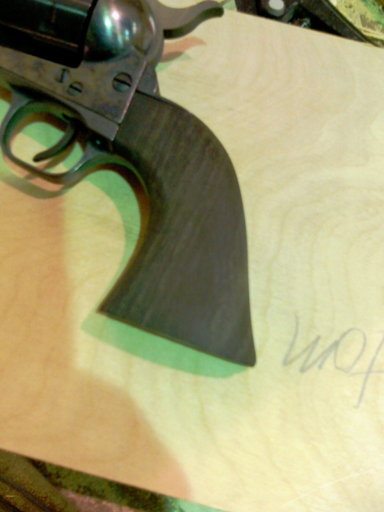

« Reply #10 on: March 09, 2009, 02:39:45 PM »

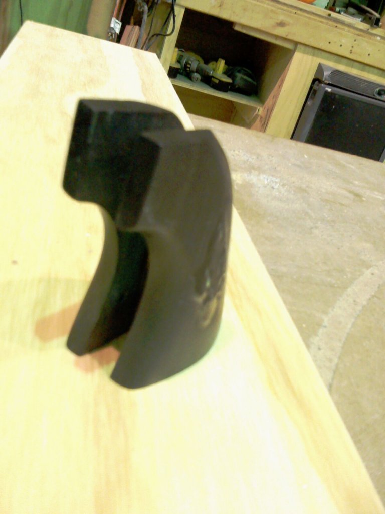

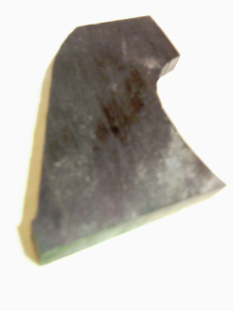

I love this colt but I hate the plastic grips, so............
I cut wedges and rough cut shape in ebony.
Rasped and sanded to shape, then fit to frame.
Cut block for inside grip, drilled for dowels and split, then glued to back of grip panel.
So far so good.

Offline GRIMJIM
  • Posts: 3002
Re: colt saa
« Reply #11 on: March 11, 2009, 03:30:07 PM »
I did the other half tonight. I've got some finish sanding to do and I can start finishing the grips. I have ordered some abalone to put inlays in them also. More pics as the job progresses.

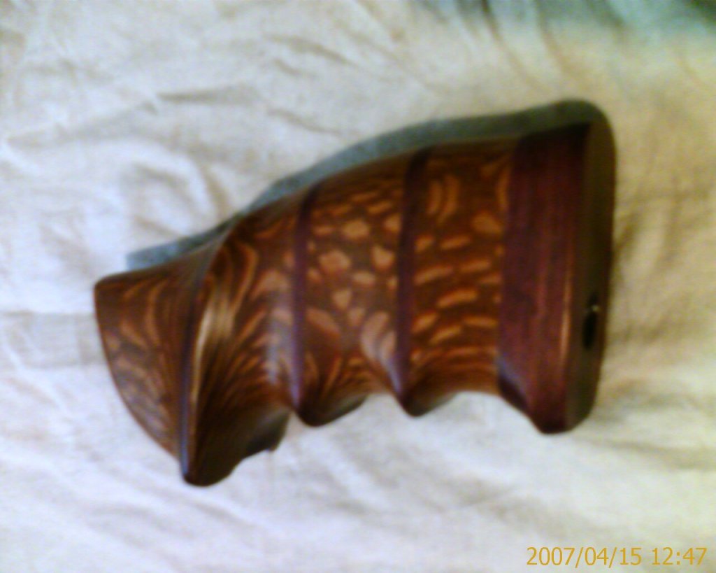

« Reply #13 on: March 14, 2009, 11:05:49 AM »
Good posting on making grips, but I prefer to align the grain with the backstrap rather than dead vertical... see below:
Flint, SASS 976, NRA Life

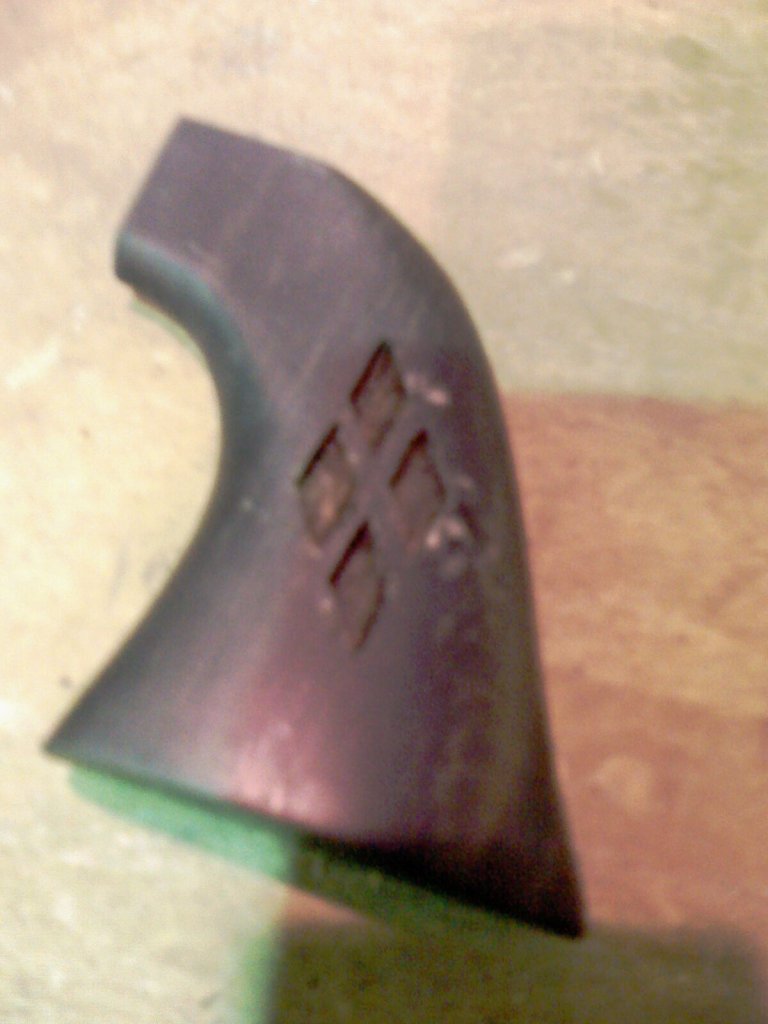

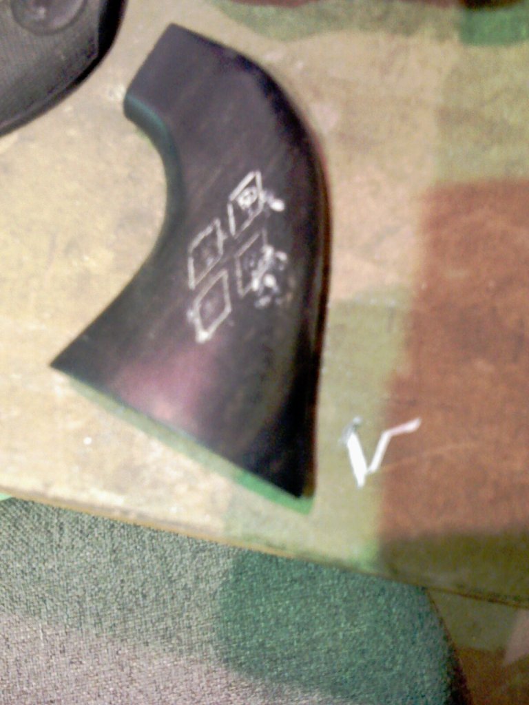

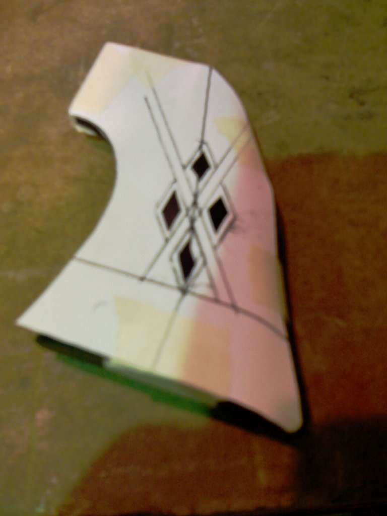

« Reply #15 on: March 18, 2009, 03:39:44 PM »

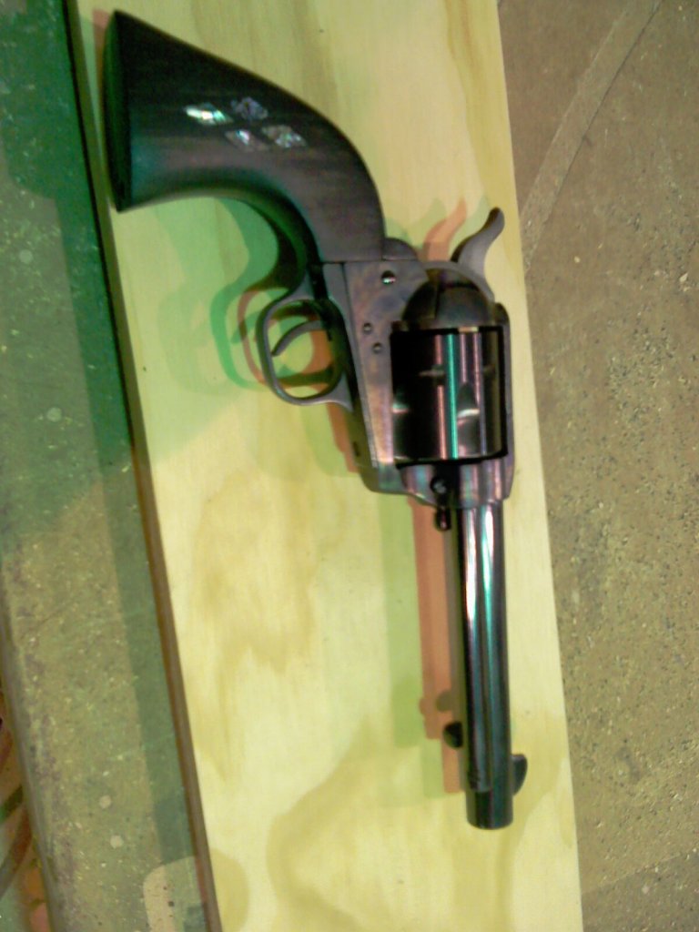

I started the inlays:
I bought some premade diamond shapes for guitars.
First I laid the loose pieces on the grip to find the pattern and location I wanted then I made a paper template, made three copies of it, mirrored the image and made three copies of those. I then taped one of them to the corresponding grip.
I termporily glued the inlays in place using the template to align the pieces. I used superglue (bad idea) and released the parts with acetone after I traced around them with an exacto knife. I rubbed white out into the cuts so they were more obvious.
I then used a dremel to level the bottoms of the cuts for the inlays, staying away from the lines. I then used the axacto knife to cut out from the lines in.
One side done, I have to epoxy them in yet but I'm waiting until the other side is done.
I used my phone to take the pics, sorry they're not too clear.

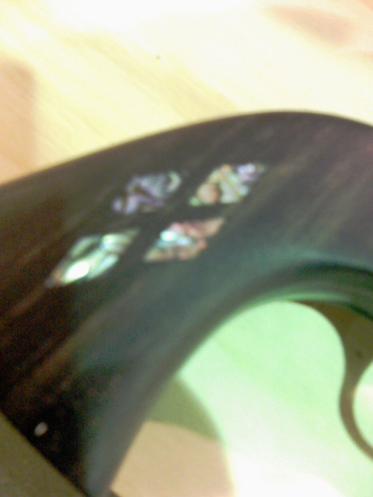

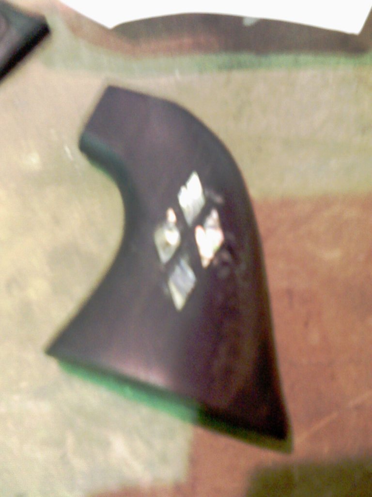

Offline GRIMJIM
  • Posts: 3002
Re: colt saa

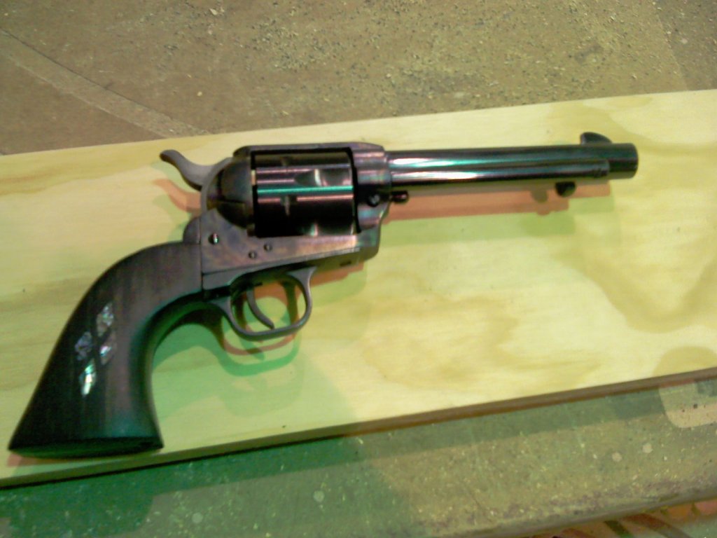

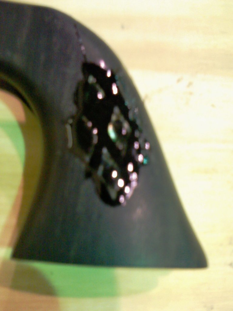

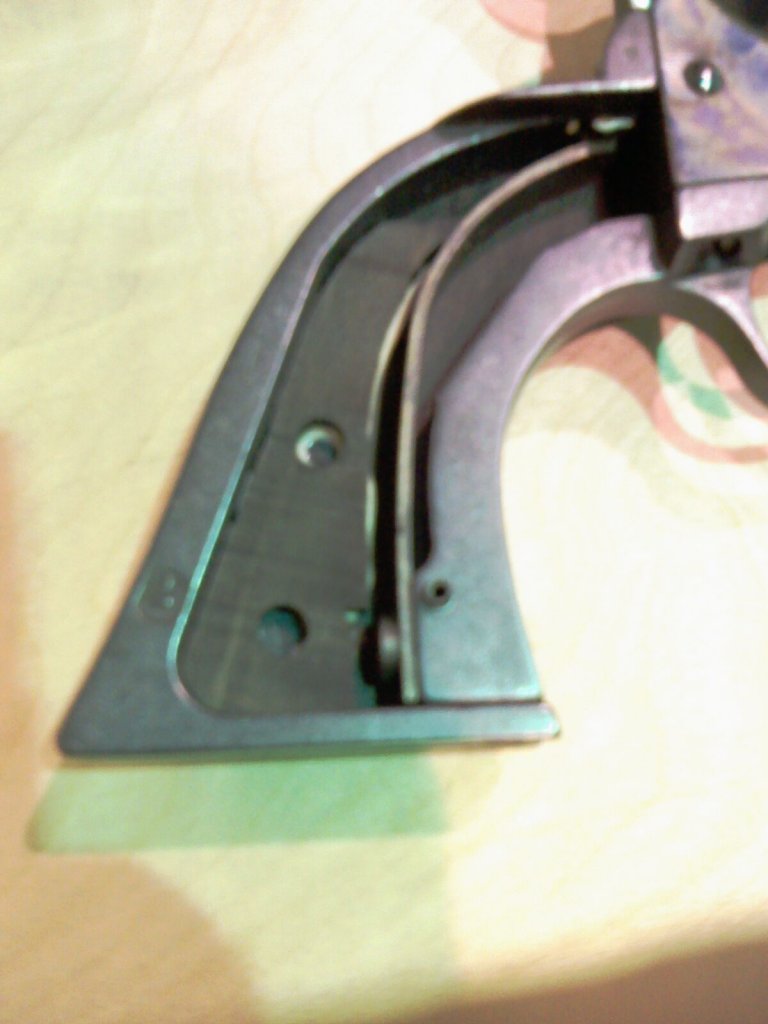

« Reply #19 on: March 27, 2009, 12:39:51 PM »
Okay here's an update.
I sprayed the inside of the grip frame with wd40 and put two layers of masking tape under the grip frame screws. I then used gorilla glue to glue the two halves of the grip together.
I used two of the copies I made of my template for a map for the inlays. I numbered the map and taped the inlays top up to correspond with my map. They only fit in one way and I didn't want to have to do trial and error when I had the epoxy all over the place.
I finally got in the epoxy I ordered. So I started glueing in the inlays.
I filed them down to the wood, and sanded with 120, 320 and some steel wool.
Here is the one side on the gun. I still have some finish sanding to do and a few more coats of antique oil finish but I'm pretty happy with the results.

« Reply #20 on: March 27, 2009, 01:25:04 PM »
sorry, I spun the last picture.

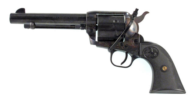

I guess I'm just not much of a conny-sewer  ;D of fancy grips really and on a Colt those original hard rubber or plastic or whatever the heck they really are just seem "right" to me on them. About the only thing my personal tastes would allow other than them are stag or ivory or perhaps a good fake of ivory since it's so hard to come by. Ivory fake or real with some good scrimshaw is nice.
