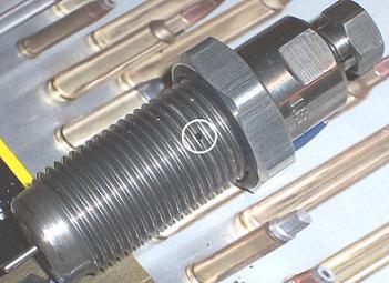

When you clean the die, be sure to clean out the vent hole, circled in the picture below. The LEE lube will pack into the hole & dry out, plugging the vent. Might try less lube or switch to Hornady One Shot or Imperial Sizing Wax.
