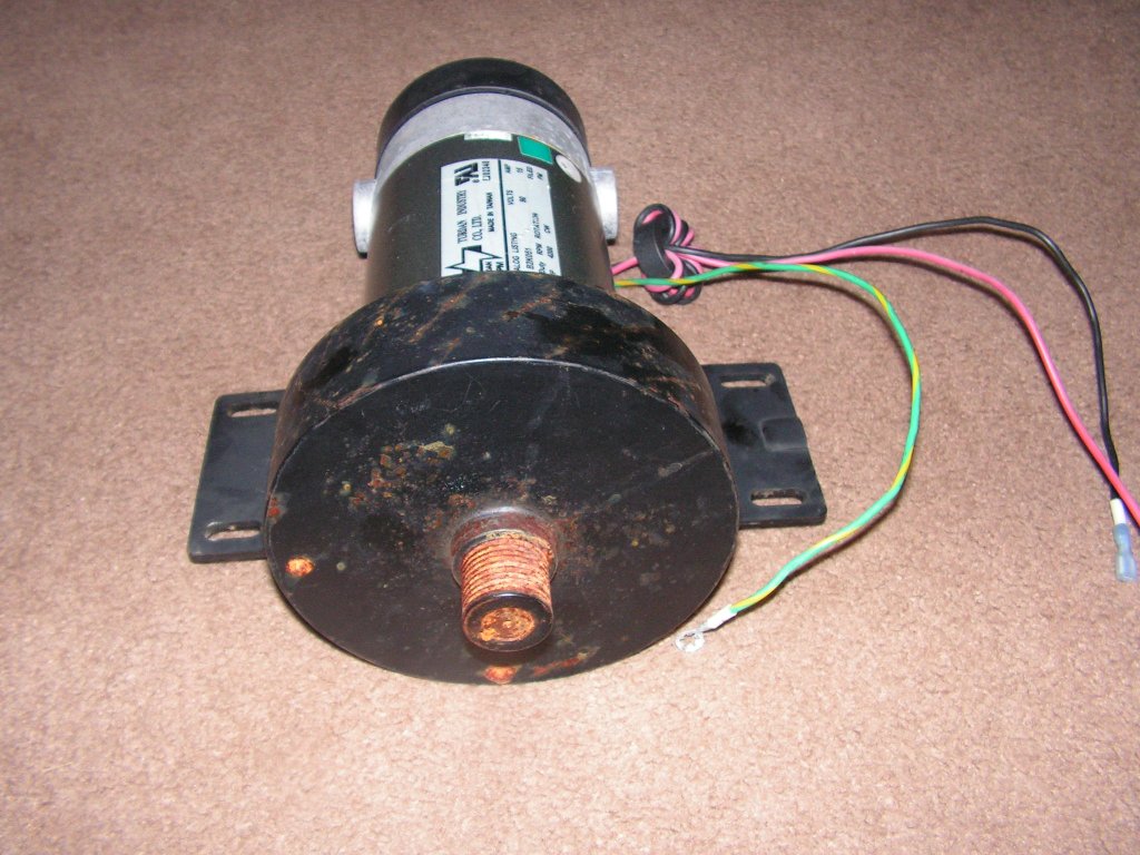

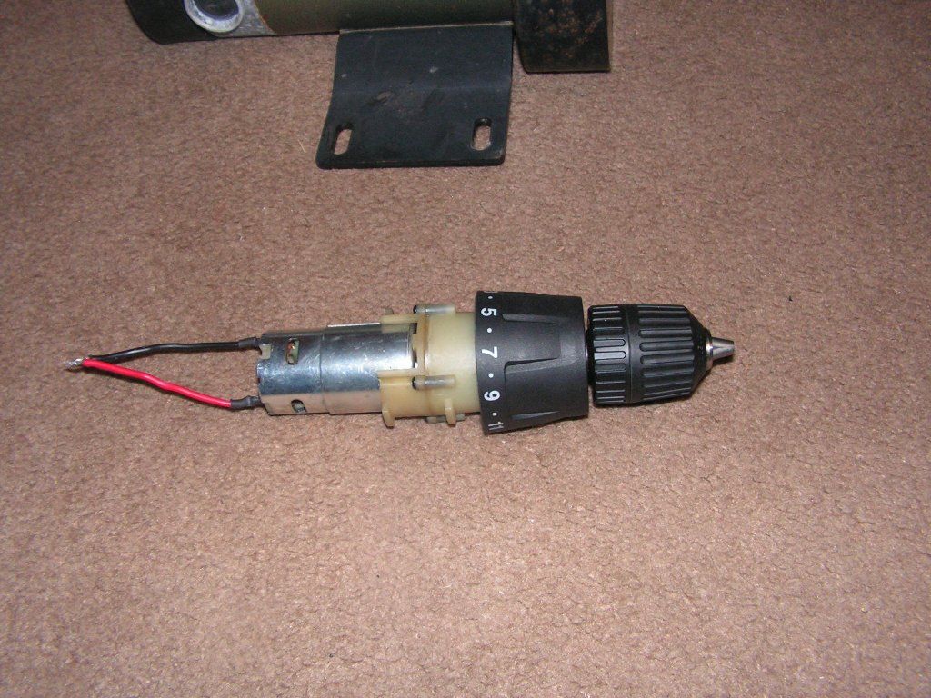

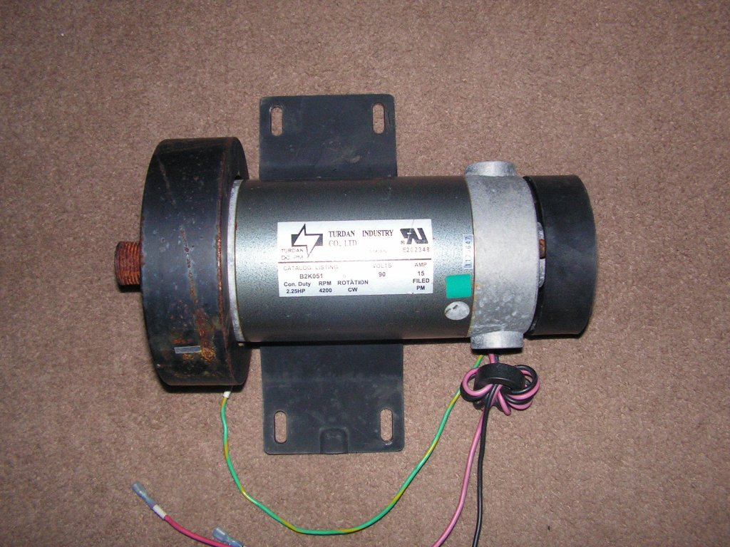

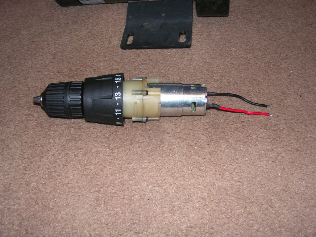

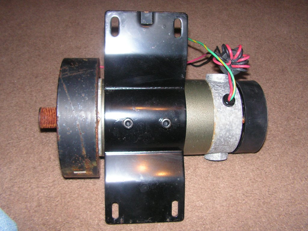

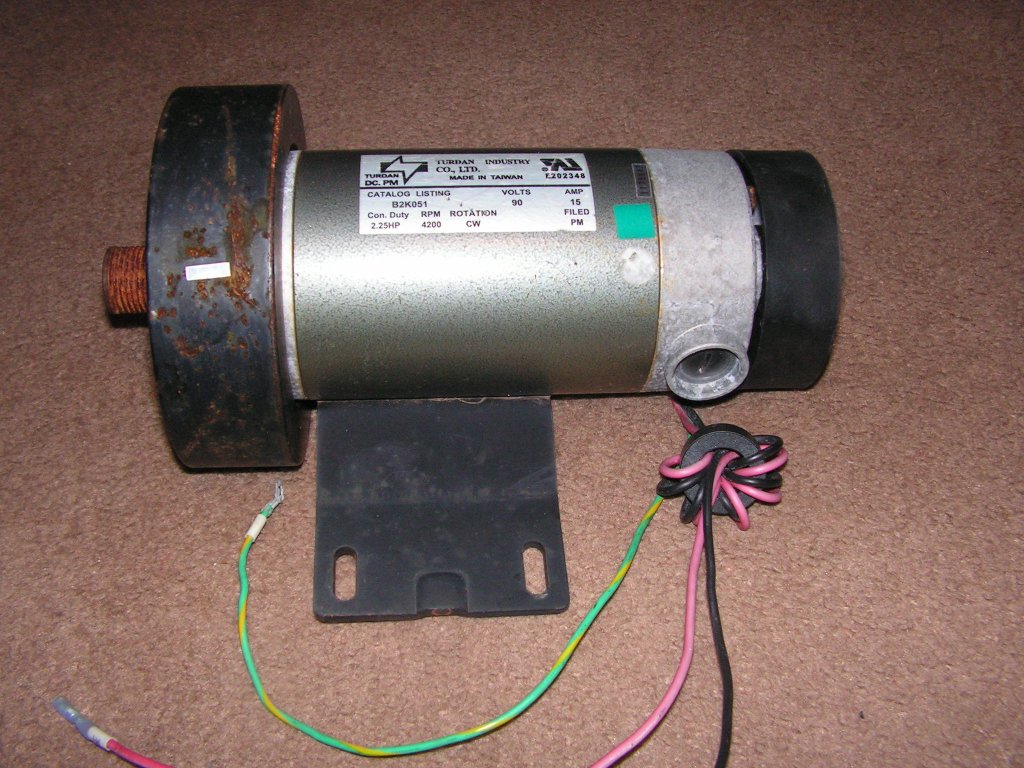

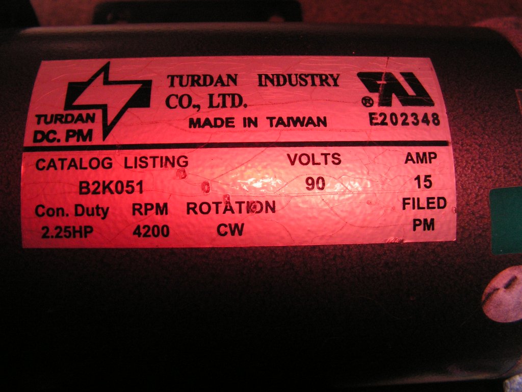

Here are some pics of a treadmill motor. This is one of the motors that I have left exposed to the weather for about 9 months and as you can see only a little surface rust on the flywheel and fading of the wire colors are about all that has happen to them.
Also here are a few pics of a cordless drill motor and chuck.
Matt
Any fool can know. The point is to understand.”
― Albert Einstein
Offline Badnews Bob
  • Trade Count: (34)
  • Posts: 2963
Re: What motor for windmill
« Reply #21 on: December 08, 2008, 01:14:33 PM »
Are the treadmill motors common to makes? I mean will most any brand do it?
We don't have good wind here in Ky but a small gen not used much may still keep a battery or to topped off, I am building a small 8X8 shack to hide out in when Iam being unsociableand would like a small system for a couple lights and a radio one or two nights a month, do you think one this size would work? I know I can buy a single or dual panel system but looks like I can build one of these for a 1/4 the price of a panel.
Badnews Bob
AE-2 USN retired
Offline Matt
  • .:{º.º}:.
  • Posts: 2130
    • Inkredible Image
« Reply #22 on: December 08, 2008, 01:54:24 PM »
 I have taken apart upwards of 50 treadmills and so far all that I have seen use a 60v to 120v DC PM Motors. If you will use LEDs for your lighting 3-5watt and then use a deepcycle battery as a power source the draw would be minimal and the low RPM wind generator should be able to keep the battery topped off. You can also use more than one wind generator to make up for low wind. Your total cost should still be less than a panel and charge controller.
Matt
