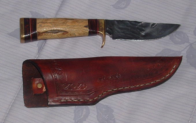

I bought a new knife.[/img] It was made by a local knifemaker using a circlesaw blade. I hope to try it out this year.

I'll try one more time.
Finally!

  Very nice! Those old blades are very hard and this knife should hold an edge really well.  If I can ask, how much did he charge for the knife and does he have any more to sell?

Nice classic looking knife.  I made a  couple out of saw blades years ago, when I knew the steel was definitely L-6, and they took a decent edge.

The knife worked great on it's first deer. It had no trouble going through the rib cage and still held it's edge. I think it would work on another without a touch up.
