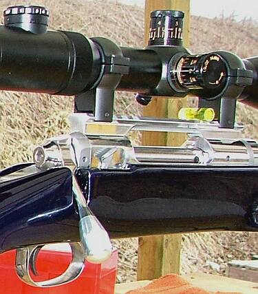

Savage Barrel Nut - one gunsmith's opinion
« on: October 13, 2008, 11:00:36 AM »
http://www.6mmbr.com/gunweek040.html
The Savage Barrel Nut--Advantages
Many gun builders will re-barrel a Savage without the barrel lock nut, by milling a shoulder on the barrel and mounting the barrel Remington-style. The only advantage to this is that it will let you fit a heavy-contour barrel with a diameter that is larger than the nut. The nut has several advantages, however. First the nut makes it much easier for the gun's owner to set headspace and switch barrels. Second, the barrel lock-nut provides a more solid thread joint and controls harmonics in a positive manner. I truly believe the barrel nut can enhance accuracy. In fact, I've made Remingtons shoot better by simply cutting back the shoulder and adding a nut.

dat rite der is a pretty nice looking rifle, shinier than my harley

well to be sure that shine disqualified the gun as anything of interest to me.. but if all that info means savage is accurate an can be made
even more accurate ..sounds good to me .. i knew they were accurate..

Yote,
One fine rig you got!!!

Yote,
That ain't mine, just a pic and article off the web...
Would be a keeper if I had it, though...
