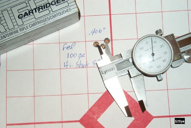

My 1:10" Ultra shoots 100gr Hi-Shoks(now called Power-Shoks) real good. ;)
