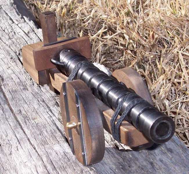

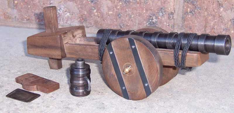

My turn ... hope it looks like a mary rose cannon ... bore is about 9mm (0.354")

« Reply #2 on: August 28, 2008, 04:44:27 PM »
it sure is beautiful .
is the surface between chamber and barrel conical ??
in the picture it looks cylindrical .

Re: Mary Rose cannon
« Reply #6 on: August 29, 2008, 11:31:58 AM »
Wow thanks guys :) .... It really started as "I’m bored, want to make some thing small". I had just finished a 1600's .62cal Matchlock musket that had taken weeks.
A friend had given me some old rifle barrels to do some thing with and I was a renactor for too many years, so all my books of stuff are pre 1600, I love the breech loaders and it looked easier and quicker than thelionspaw 15th cannon. I have a small lathe so I cut a bit of barrel up to see if I could use it on the lathe, it fit and worked nicely. Turned the barrel down to shape then fiddled with getting the breach to fit nicely, I wasn’t sure how the breech end was shaped as most of the pics I found in books and online don’t really show it so I made it up. The handle on the breech I put there to cover a miss drilled hole  ::) but happy I did I like the look of it now. The wheels are not "right" should be spoke wheels I think, I rushed to finish it and they were easy to do.
After seeing Richards 15th cannon I'm making a big bother to my small one, with a 20mm bore have the barrel turned up now need to finish the breech for it. I want to use it as a swap over barrel and try and make two carriages for it, a mary rose one and one like Richards.
The carriage is a bit of left over walnut from the musket. Ill do my best to get some smoke out of it for you all.
Thanks again
Owen

I tried thinking through the physics of this type of breechloader thing when I saw the lionspaw cannon thread.  There is something to it I don't grasp.  That Nat Geo pic is interesting, with a linear cut in the barrel and multpile reinforcements there.

Doc, What don't you grasp?  Maybe I can help.
Here's the alternate way for construction.
Me?  I made "The Lion's Paw" the third way by combining the illustrated two examples.  i.e. the sheet of iron around the mandrel of the National Geographics, followed by the bars of Hogg's around the sheet. Then for safety (not authenticity) a seamless tube over-all which was then encircled with 1026 SupraDOM bands having tensile 99,400 and yield of 89,800.
I'm not an engineer but I still feel safe.
I was referring to the breech design and how the pressures are contained there without separating the breech end from the tube.  I understand the forces of acceleration and inertia, but I'm not an engineer, and it's more the pneumatics that stump me.  I do understand the illustration better now.  It makes me want to build a bamboo cannon (relax, I won't). :)

Doc:
The seal is never perfect and the wedge, driven in with a maul, is adequate enough.  We're not dealing with a bolt action rifle. My wedge is chained but for availabilty and not security.  I now have the block itself chained to improve the seal and restrict recoil movement.  It used to hop a bit. One might even venture to say that the release of pressure is good to have?
Richard "The Cautious"
