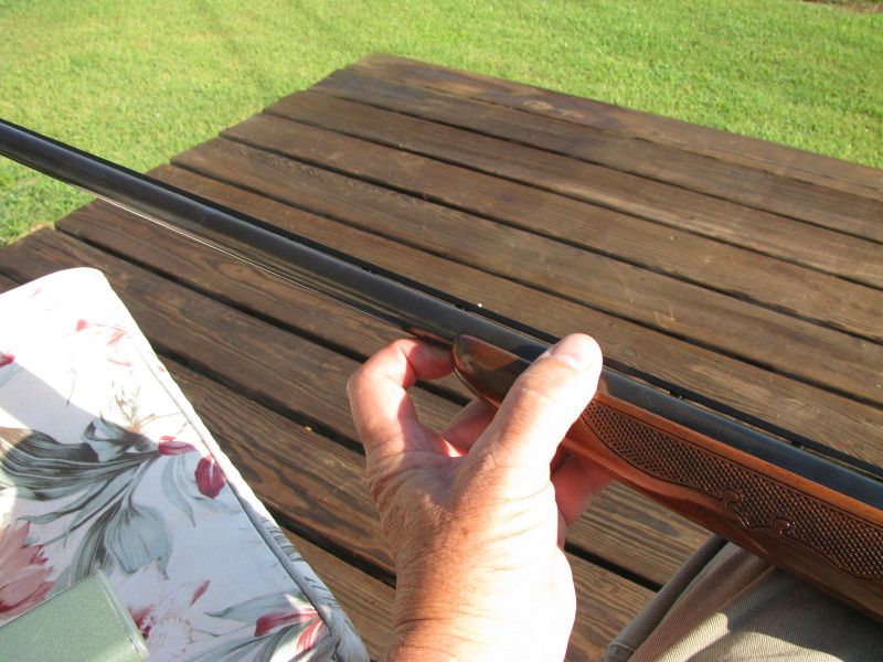

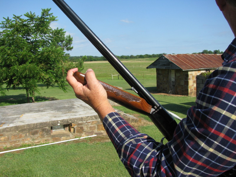

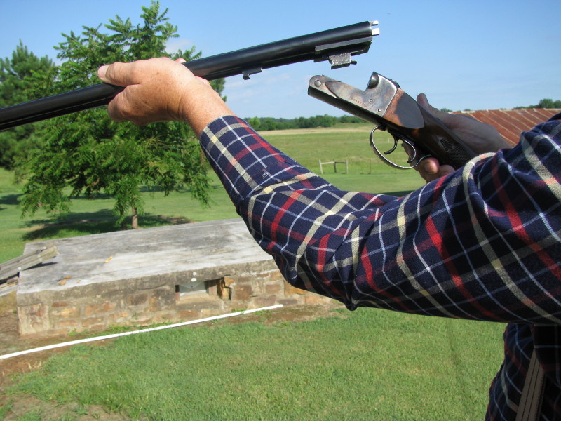

Okay;  Here is a FOX B being broke down.

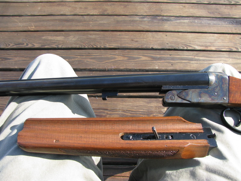

32WINSPL; Unless your gun has been altered, this is how your gun's Forend should look.

              Thanks for your persistence. The pictures really tell the story and I was able to perform the barrel removal. I was doing the job incorrectly. Thanks also mcwoodduck. You guys were great!
