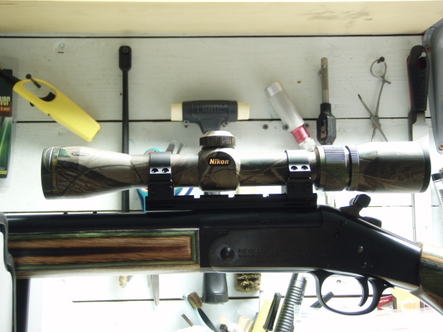

Heres a little update on my project. I decided to go with Warne Maxima LOW rings. It appears as if I have approximately 1/16" clearance on the hammer. Is that sufficient or should I grind the hammer down a bit? I don't want to cut it too tight.
I will say when I had the HIGH Loopies on I thought the gun fit pretty good, however when the LOW rings went on it was night and day.
Re: Scope rings on a Ultra Slug Hunter
« Reply #9 on: May 21, 2008, 12:06:50 PM »
1/16" is plenty if it clears the swing of the hammer, I have less than that on several.  ;)
