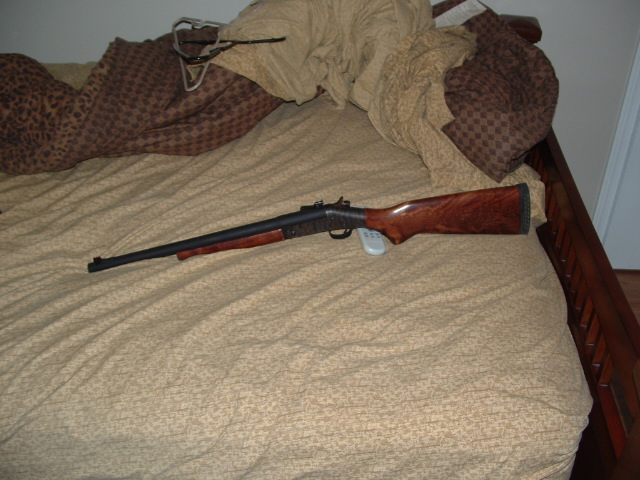

Offline STUMPJMPR
  • Posts: 1037
Here is the finished product...I cut it to 18 3/4" and it will shoot about a 2" group at 50 yards with remington slugs but it kicks like hell.....

Offline db22
  • Posts: 343
Stump: Whoa, that stock is mighty nice! The gun looks terrific! How difficult is that paint to handle? Does it require baking? You have done a really great job -- now I will have my eye out for a Pard that has seen better days . . .
"The said constitution shall never be construed to authorize Congress to prevent the people of the United States who are peaceable citizens from keeping their own arms." -- Samuel Adams
Offline STUMPJMPR
  • Posts: 1037
I didn't do anything to the stock...I just ended up painting the barrel...The receiver and the  barrel had a little rust...I couldn't bring myself to paint over the case hardened finish....the duracoat is very easy to apply all you need is a cheap airbrush...It does not require baking it drys almost instantly and cures over night....Its a 2 part part paint just mix it accordingly...degrease the metal using laquer thinner and you will need some acetone to clean your airbrush....You can buy everything from midway it will run you about $50 and its enough to paint about 8 guns...
