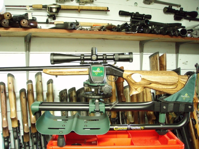

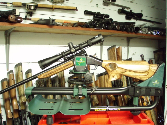

Smart is using a Lead Sled DFT, very Handi friendly!!  ;D
