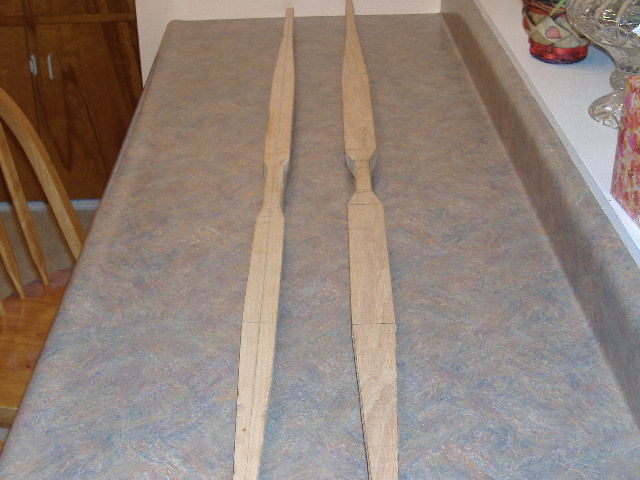

Recently I've gotten into woodworking a little--- I'm making my own bows. See the traditional archery thread. I'm working on a couple of flatbow self bows right now along with a laminated take-down recurve. Both have been very fun projects. I will get some pictures of the recurve on here later.

Looks like you are doing a good job. What kind of wood are you using? Carl L.
The one on the left is maple, the one on the right is hickory.

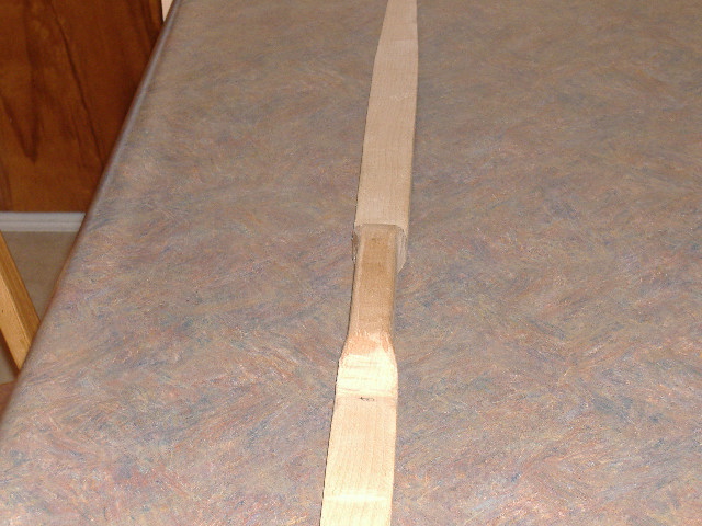

Here are the pictures of my take down recurve project from plans I got from Bingham Projects. See the Traditional Archery thread for more info on Bingham projects: http://www.gboreloaded.com/forums/index.php/topic,136859.0.html
I broke my first riser trying to string it.  :-[ I placed it between two pieces of round stock that I tack welded to a welding table, and then used a come-along to try to flex the limbs to put the string on. My thought was that this would be like putting it in a bow press. Well, it didn't work and I was sick after I had shaped on the riser for a month, a little at a time. :-[ ;D
My heat box. This required to set the epoxy that is used in recurve making. I tried to be cheap and just use a sheet of underlayment insulation with the foil on one side. This does work, but it won't hold up for very long, if anyone decides to try bow building go ahead and use the plywood lined with aluminum foil like the instructions say to do.
My limb press with air hose(this is a fire-hose) installed. The limb laminations are glued and placed in this, and then the hose is inflated pressing the laminates together tight. This is then placed in the heat box and sits for 6-8 hours to cure the epoxy. A bit of advice: do not use PVC pipe fittings for this, only steel ones and make sure you test it in your hotbox before you glue up a limb-- I learned the hard way-- I was able to save the limb, but with a lot of headache that could have been avoided.
A picture of my first riser that I broke. This one was white oak and mahogany laminated together. It took me about a month to shape this one, a little at a time. I was sick when I broke it. The second one only took me a couple of days, the wood is solid red-oak and is not as pretty but it looks well enough.
Here are pics of it almost finished with the 2nd riser. Specs are 64" AMO 60lbs at 28"draw. Left-handed as you can see. I still need to add the limb tip accents, finish filing the string groove, remove the protective tape from the limbs and give the entire bow a finish sanding and then aplly polyurethane. I'm still debating on whether or not to lightly stain the riser and limb wood first.

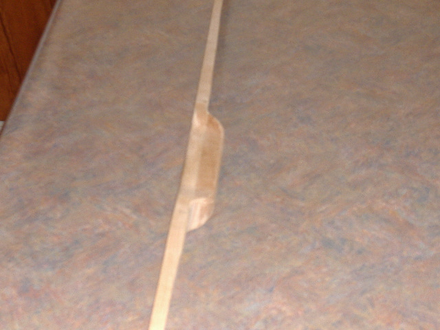

Well I finally got my recurve finished,( along with a dozen honey-do's  ;D) Now comes the real test: and that is how does it shoot? here are some pics:
And last but not least, here is the next one that I've started with a walnut riser...  ;D
