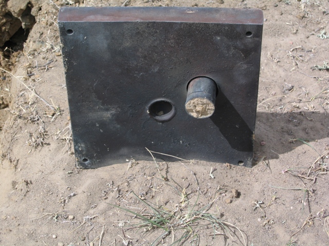

     Several people have asked us off line for an explanation of that other big dent or gouge in the ultimate proof load target plate.  Some of you, who have seen the impact test photo gallery on our web site under the menu "Shooting", probably know how that .712 deep gouge got there.  Two years ago we did a maximum proof test of the last prototype, completely machined, 1/6 scale, 100 Pdr. Parrott Rifle that we made.  The photos below tell the story.
The Parrott bolt proof test gouge to the left and a little below the Brooke bolt lodged in the 1" thick boiler plate.
The 100 pdr. Parrott proof load projectile, front row, left is a composite bolt of 12.5 oz. and made of a 12L14, Ledloy carrier of 1.067" dia. and a 1.500" long hardened 0-1 Tool Steel penetrator which was .750 dia.   A lot of energy resulting from this mass going about 1,500 fps ahead of 975 grs. of BP was wasted by both metal masses changing form as much as they did.  Depth of penetration suffered because of this.
The 12L14 ledloy carrier "banana peeled" spectacularly as you can see using up a portion of the energy available for penetration and likewise with the 0-1 hardened core "penetrator" which was not hardened nearly enough.  Two propane torches just won't cut it!!  Now we have an Ebay heat-treat furnace, so we can do the hardening and tempering correctly.
     If any of this is not clear, ask for more info.  Glad to help out.

Edited to add: T&M, I was wondering about that center dent myself. Thanks for the clarification.
