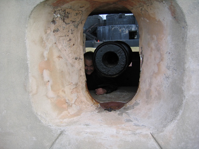

In the upper left of this embrasure at Fort Sumter, Charleston, SC you can see a couple oyster shell pieces in the Tabby which surrounds the gun muzzle.  There are four materials in use in this embrasure.  They are Tabby, an iron plate around the inside edge and of course the brick masonry under the Tabby and the modern repair cement of the outside edge and outer face.
    Mike, "Fire up the oyster shell furnace!"
