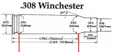

I have just bought a new Savage and I am having trouble with the brass chambering.  I have trimmed the brass to length and used RCBS full length dies on the brass. I have even put a bullet in the case and put a rolled crimp into it and without a bullet.
And before you ask... no, I did not crush the case.
I have miked the case and is showing .470 at the base and .455 by the tapper and case length 2.015.
Any Ideas?

Maybe too obvious but... will a factory round fit OK?
Did you try laying a flat edge on the area between the red marks to ensure it's flat? No bulge indicated?
Did you try running your die down 1/4 turn? Maybe not fully resizing the brass.

corbanzo, the measurement to the shoulder and neck are in spec... 1.560 and 1.712
the angle 20 degrees look right.
Is there a limit to the neck thickness?
If I had that measurement then I could figure if that angle is right with a little algebra.
