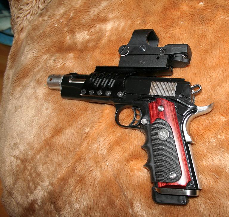

« Reply #21 on: May 27, 2008, 10:40:31 AM »
Okay here she is. Please be kind and take into consideration I have no gunsmithing experience or metal working tools. Everything was done with a drill press, handfiles and a dremel.
It went from this:
To this:
I am unhappy with the paint I used for the frame and slide. It's too thick and made everything too tight, but with a little cycling and some gun oil it loosened up quite a bit. I might strip it one of these days. I messed up the slide, I wanted to put some angled slots in it to match the scope mount and messed up and ended up with the large ovals instead.
I wanted something a little more involved than the 10-22 I did and this certainly was it.

Offline SharonAnne
  • Posts: 1994
  • Gender: Female
Re: AMT hardballer
« Reply #22 on: May 27, 2008, 11:02:27 AM »
nice first effort/ can we have some closeups of the beavertail,slide cuts and comp?

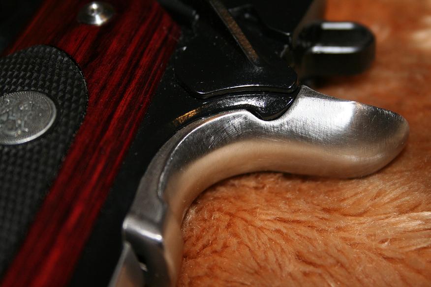

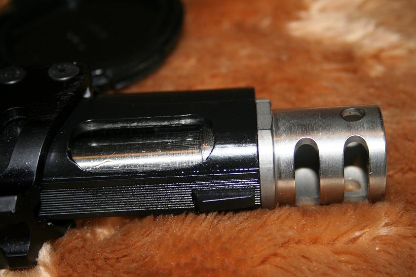

« Reply #23 on: May 27, 2008, 12:50:49 PM »
beavertail
slide cut and comp bushing (not as good as a regular comp I know)

Offline SharonAnne
  • Posts: 1994
  • Gender: Female
Re: AMT hardballer
« Reply #24 on: May 27, 2008, 02:45:03 PM »
VERY nice fit on the beavertail. no 'first time' qualifier needed. nice work.
RE: the comp. not interested in the comp. I was looking for fit. I cannot see bushing fit but the slide cut is certainly nice and clean. I would put a slight bevel on it to remove the sharp edge and give it a nice custom look. again, very well done.
