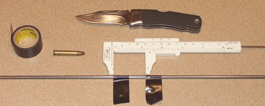

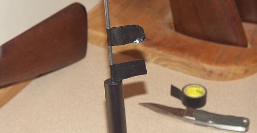

The attached photos help show how I determine what overall cartridge length should be. First I put a rod down the rifle barrel with the chamber empty, and mark the length from breech face to muzzle with a piece of tape. Then I drop a bullet (not a loaded cartridge) into the chamber and gently tap it so that it barely is stuck in the rifling. Then I again put the rod down the barrel and mark the length to the front tip of the bullet.
The distance between the edges of the tap will be about the cartridge overall length where the bullet would touch the lands. In reality it is slightly longer because the bullet was not just touching the lands, but barely stuck in them. However, for practical purposes, if one seats bullets to allow a jump of 0.04 or more to the lands, this method works fine. I generally repeat this three times using different bullets to be sure my measurement is accurate, but usually get essentially the same measurement each time.
Of course, if I want a bullet jump of 0.05-inch from the lands, I subtract that distance from the measurement and use it for loaded cartridge overall length. One needs a rod with a flat end or a cleaning rod with an attachment with a flat end. This costs less than buying a special tool and for me has worked much better than other methods I've read about. Also, it don't take much time.

« Reply #24 on: July 23, 2008, 05:51:09 AM »
I don't know why the second photo did not show up in the above post, but just click on the photo address and it will. For reference, the cartridge in the photo is a .22 Cooper Centerfire Magnum (.22 CCM). That was Cooper's centerfire version of a .22 rimfire magnum, with the versiltility of being reloadable.
