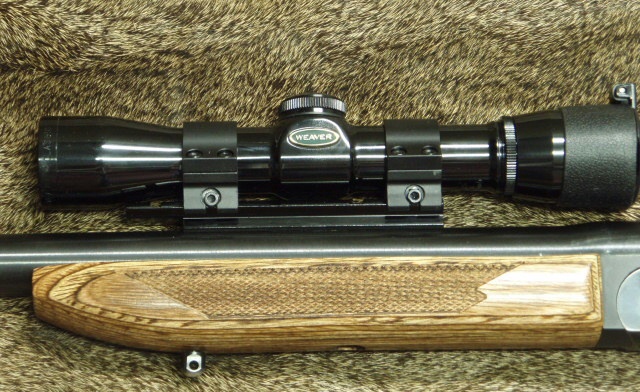

See the scout mount ideas in the FAQs and Help sticky, the Weaver 92A mount works perfect, I used a Weaver 2x28 scope on mine, works great as far as mounting and FOV, haven't shot it yet though, and I think I'll drill and tap at least one more hole since the barrel only has two.

Use a Weaver #92A base for the T/C Contender.  The radius on the bottom doesn't match the Handi barrel, but is close enough.  2 of the screw holes in the base will match the holes in your barrel.  You could glue it to the barrel with JB Weld, but the .357 shouldn't kick enough to loosen it.  Pick up a 2x pistol scope and rings and you are there!
I have 2 set up this way, a .30-30 without the JB Weld, and a .45-70 that has JB.  They work very well.  The .30-30 shoots 1-1/16" at 100 yd. with my coyote load.

I dunno what it actually is,  it's supposed to be 14"-29", they just dropped the 1 off 14", but it's perfect on the rifle, I think the 14" is a little longer than it really is, as near as I can tell, my eye is ~12½" from the rear lens, if I move back further, it doesn't change, but it I get closer, the FOV reduces.
http://www.binoculars.com/rifle-scopes/rifle-scopes/2x28silver.cfm

I find that it makes for faster target acquisition.  Also, it lets you carry the gun at it's balance point without wrapping your hand around the scope as well as the gun as the pictures show.  I tried it and liked it.  Others don't like it.
