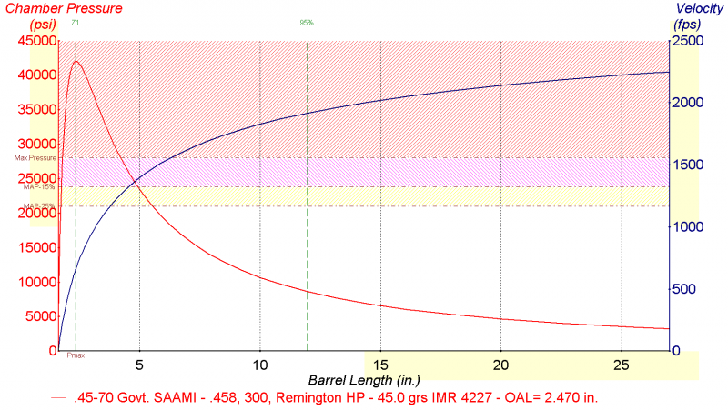

SmokinJoe,
I looked at my recipe and it says I stopped at 45gr. That must have looked almost full to me, that's a lot of powder compared to the Hornet.  I have only shot this in my Ruger #3. The 35 whelen I found that I could use the .358 Hornaday Single Shot Pistol Bullet with IMR 4227. I shoot this out of a Ruger MII. I think I will start using other powders though. I'll have to take a trip to Oklahoma City so I can get some differnt powder. I use the IMR4227 for these:
Pharmboy

« Reply #20 on: February 17, 2008, 05:27:49 AM »
Unique,
Where did ya get the software to create that graph? It looks like I was pushing the envelope.
Pharmboy

« Reply #21 on: February 17, 2008, 06:03:03 AM »
Unique,
Pharmboy
The program is called QuicklLOAD.   I shoot 30gr IMR4227 with 340gr cast in 45-70 so I had an idea your pressure/velocity would be up there. I was a little concerned that someone less experienced might want to try your load in a Trapdoor. That would be bad.
One problem with the 45-70 is too much case capacity relative to smokeless powder (good for black powder) and IMR4227 is fine grained powder which exasperates this problem.  I have experienced very extreme pressure/velocity profiles based upon where the powder is sitting in the case.  For your load you are at 90% fill but still you may experience even higher pressures if your powder is back against the primer as opposed to front of case against the bullet.
Having said that, I tend to shoot lots of IMR4227 in 45-70 because it is just so plum accurate with cast bullets even with the extreme velocity dispersion shot-to-shot.
