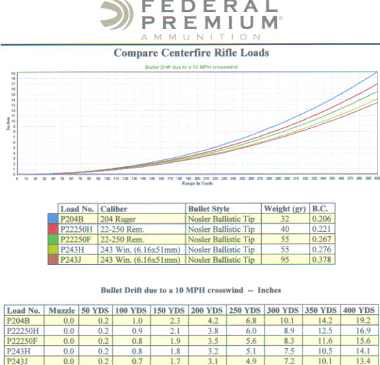

Offline PartsMan
  • Posts: 1351
  • Proud Handi Owner
    • myspace
Re: Which caliber for varmint shooting in the wind?
« Reply #17 on: March 27, 2008, 08:41:35 AM »
Maybe this will help.

There is a pattern for B.C.
Higher B.C. and velocity are the key to beating the wind.

What is required is a balance of velocity, BC and bullet weight.  None by itself guarantees anything.

That is what I am saying. It is a combination of all three. Dale

Try the 87 gr V-Max (BC of .4) at 3450 fps out of 26" barreled 6mm Remington with 12" twist. 38+ years of PD, rock chuck and picket pin long range shooting (200-1000 yards) says that's the one.  I base that on actual shooting not computerized programs. I've used all sorts of cartridges from .22 Hornet, 17 H&R up through the 6.5-280. The 6.5-280 with a 120 MK at 3250 comes in a close second. Although they come out pretty decent on the computer too!

Another great wind combo for varmints in windy conditions is a 25-06 with 85 grain ballistic tips. They have a BC of a little under .400 and can be run around the 3500 fps mark with careful handloads. Reloader 22 seems to get the most velocity out of this bullet for me.

Some interested stuff here, but basically, speed shoots flatter, high BC's buck wind better as stated. I can deal with rainbow trajectories quite easily, reading the wind right can be frustrating at times. I'll take high BC's any day over speed, but specially once you start pushin in to and past the 6 - 800 yd.  But speed is good thing at under 500yds, however I do use the speed demons for certain things at certain times.
 Your thinkin of the 22-250 and heavier weights would be good choice depending on range.
better yet would be a 22-250 AI and the 90 grainers, then you are talking 1000 yds plus rig. And better yet would be the 22-243 or variations there of. But for bucking wind and long range work, I prefer the 6mm AI and VLD's.
What ever you do, just make sure your barrel has the twist for the bullet(s) you want to use.
I do use the 220 Swift with 40 gr. well over 4000fps, but is pretty useless in a stiff or varying breeze once past 4-500 yds. (granted 50's or 55's would do better)...Then I move up to the 6mmAI using 55gr at 4000 fps+ out to 800 (pending the wind). Beyond that I use the 6mmAI fast twist 107 or 112 VLD's  for bucking wind at long range. Also I'm thinking on the .22-243 in a 1-7" twist, just to fill a small niche.

Bullet weight is wholly irrelevant. Wind drift is a product of BC and TOF.
In any given cartridge the following "generally" applies:
for shots under 500 yards a light/fast bullet will be less affected by the effects of wind
for shots over 500 yards a slower bullet with increased BC will resist the wind better
A high BC bullet is normally too much slower than a lighter/faster bullet to make up for the short TOF of the fast bullet. However, light (lower BC) bullets loose velocity much faster and loose the advantage  of short TOF over the long haul. This is where the more efficient high BC bullets catch up and pass the lighter bullets in both velocity and wind deflection.
Remember - I said GENERALLY. One can always pick out specific comparisons that would make this premise seem incorrect. I am also talking about comparing apples to apples and am not comparing small varmint cartridges to voluminous biggame cartridges. There are obvious advantages to using magnum cartridges but there are also obvious disadvantages.
The most wind defying varmint cartridge that I ever hunted with was the 22-243AI using 75-80gr bullets at considerable speed.
