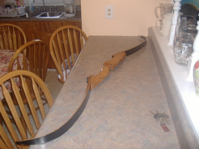

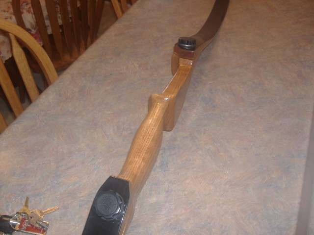

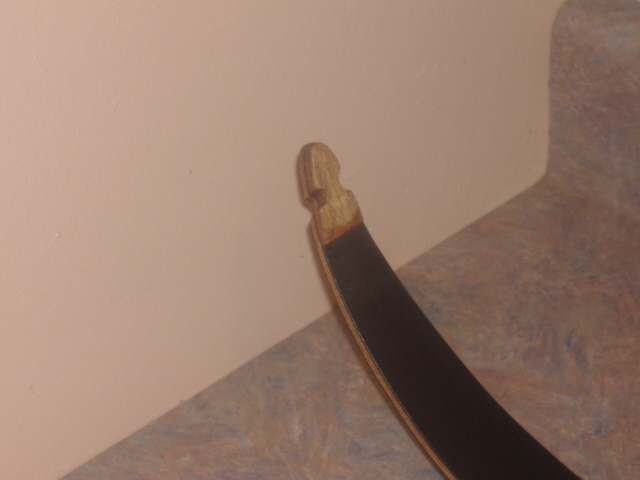

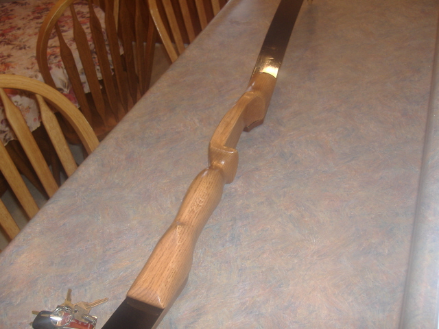

Well I finally got it finished,( along with a dozen honey-do's) Now comes the real test: and that is how does it shoot? here are some pics:

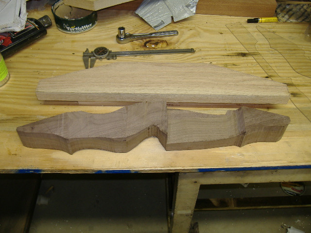

And last but not least, here is the next one that I've started with a walnut riser... ;D

Well, the bow shot great. I got my wife to put the string on it while I pulled it with the stringer. After shooting 25 or so arrows and putting most of them in the lung area of my 3-d target, I got her to help me unstring it. She got the string off the limb, and I was letting it down when the riser snapped and the limb smacked her in the face right under her eye. :'( :( :-[ The whole side of her face will be bruised bad. Needless to say, this is my last dealings with bow building. I threw it all away, if I decide to still go with traditional archery I'm going to just buy one and be done with it. :'( :'( :'(
