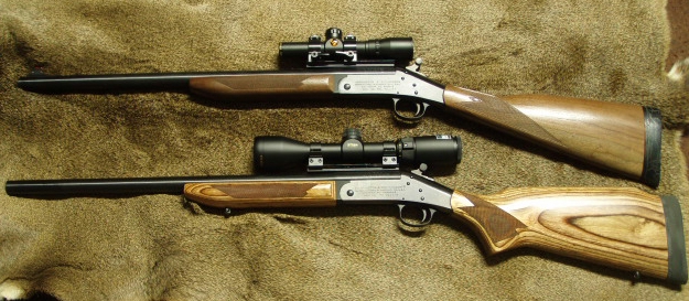

See the low profile hammer mods in the FAQs and Help sticky, if you remove the very tip of the hammer spur that's above the extension, you may be able to mount in medium rings, but to mount in low rings, you'll have to remove metal from the hammer extension to allow it to mount lower on the hammer so you can remove more of the hammer spur as on the bottom 45-70 in the pic with a 3-9x40 Nikon Omega with 5" of eye relief mounted in low Leupold PRW rings.
Another option is to use a low power shotgun scope that's short enough to mount ahead of the hammer as on the upper 45-70 below, that's a 2½x20 Simmons 8 point with 5½ of eye relief, mounted in low Leupold QRW rings.
