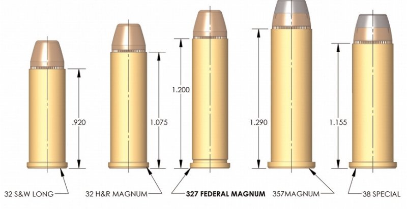

Cylinder length might be a problem.
Dave

My 357 SP 101 cyl. is about .060" longer than the 32mag cyl., which would seem to still be enough based on case length.  Since I don't know the ctg. OAL, I'm not sure..  I'm not intereseted in a second cylinder only because the project won't happen unless it is simple and affordable.  Which is why I inquired about the cost of rechambering.  My idea was to get a "new" gun without adding to the bills that I pay for other guns I bought in the past.  I should probably be on a financial recovery site but I am not ready to quit.  Is anyone aware of an online source  for ctg. specs.?

The second post graphic only showed case length rather than overall loaded length.  I do read and pay attention in spite of having FNG computer skills. The second cylinder idea would only help if I want to have interchangeable cylinders. I can't imagine that I can find a take-off 327 cylinder and if I got a 32 mag cylinder I would have to rechamber that.  I can't believe that stabbing my cylinder with a 327 reamer is is all that complicated. If I cant keep it simple and affordable,  I would do almost as well using loads published under Brian Pearce's byline for the 32 single-six.  If SAAMI specs had been set for this cartridge in Rugers in the first place no one would have ever bothered with the 327.  The 32 mag was hamstrung by coming out in the H&R platform.  With a case volume =/> than a 9mm and used in a platform that handles 357 rockets, why wouldn't a Barnes x-bullet do the job in the 32 mag at reasonable pressures any way?

S A Webbx1:  The only source I am currently aware of for cartridge specs for the new 327 chevy magnum is the Shooting Times article that introduced it and a copy of the photo comparing the various cartridge lengths is posted in this thread.
But, as to your question of whether a Barnes X-bullet would do the job, even in a 32 mag, I would say Yes, it certainly should.
But, one concern I have about just boring out a cylinder is the extraction platform for the 327.  I do not doubt the 32 mag uses the same type of extraction platform as does the 32 S&W, 357 and 38 spl.  However, if you take a look at the cartridge design, the case wears an extraction groove before the rim and the rim does not look as 'healthy' as do those rims on a 38/357 - actually, kinda looks like the piddlin' little 'semi-rim' of the 38 Super and this makes me wonder if the 327 isn't really a semi-rimmed cartridge and if that would make any difference in case extraction.
Also, when you look at the stated length of the cartridge, the 'extraction groove' for lack of a better term, looks like it does little but cause the cartridge case to simply be longer without much real additional powder space.
I agree that I sort of doubt anybody really has a bunch of 32 mag cylinders around that you could modify or have reamed and I don't know what the cost might be.  Heck, you could probably load a 32 Mag to the same performance levels as the 327 as the case capacity between the two is probably less than that between the 38 and 357.  Mikey.

I did not see it said elsewhere so I will, the 327 case has thicker walls and is built to withstand higher pressures than the .32 H&R, so I think loading the H&R to the 327 level is pretty much out; at least I would not go that route. One could cut back the case, ream the interior to proper depth and then go about it, but that would be more work than it was worth in my opinion. Buying another cylinder and reaming it would be the best bet in my opinion.
