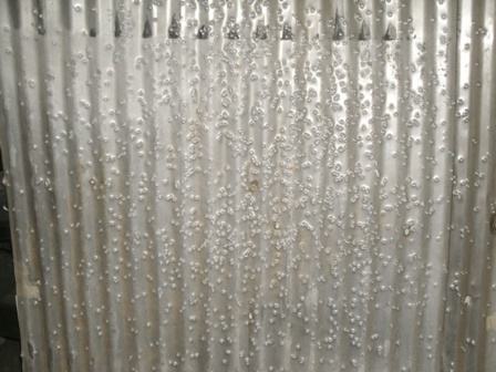

12-30-07
33 degrees / 8 mph 45 degree angle wind
12 ga. Partner Turkey Gun 3.5" chamber / fixed full .695"
Standing Off Hand / No Support
40 yards
1)  Federal Power Shok un-plated no 4 Buck / 2.75"
Results- 4 inside 8" square
2) Remington Nitro Turkey Hardened un-plated no.4 shot / 3.5"
Results- 33 inside 8" square
Notes-  The 3.5" shells re-coil really is not bad at all   from standing position, shooting now and then.  Its from a bench or shooting often it gets ya.  The re-coil pad on the Pardner is not bad either.
Soon,  I will be testing some of the 3.5" hevi shot (yes, you can shoot steel,hevi,etc. from a non-choke tube modern Pardner.......I called) in Bs or Ts and will post.  Its expensive,  I vowed not to because of this but, shooting / testing is fun and here in the Northeast I just dont shoot at called in Predators enough to worry about it.
One more note-  My tests will be from standing off hand.  With ear plugs its almost fun..........cant say the same with a shotgun from bags.  Last........in the field I shoot standing off hand to boot.

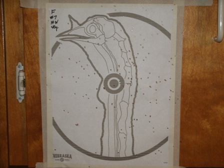

* Date 1/12/08
* Shotgun & Choke Pardner 12 gauge Turkey
* Weather Conditions Upper 30's low wind
* Rest,bags,etc. used. NONE - STANDING OFF HAND
* Yardage to target 40 yards
* Ammo / Load / Tested  Remington Nitro Mag 2.75"  # 2 Shot
* Results Favorable
* Photo of target if results are favorable
Just spoke of these and found them at the local gun shop in 2.75" # 2s.  So I patterned them.  $20 bucks for 25.  Thats a heck of a lot better price than some stuff I have been testing.
From standing off hand I fired just one shot at 40 yards
Results were favorable as noted. 37 hits on 14" x 14" / 14 hits in 8" x 8".  Not bad for off hand. I hit where I aimed to slightly high which I prefer.  I am becoming a big believer in the Remington Nitro line of truley hardened lead shot and buffered loads at a honest price.  As with my Nitro Turkey 3.5" these patterned well.  I have patterned allot for predators since this fall.  Lots of number 4 buck, along with 000 buck, hevi BB shot, # 4 Turkey and now # 2 shot.  From premium to value from 2.75" to 3.5".  I was probably the most disappointed in some of the Premium loads.  I never did get real good patterns from # 4 buck.  Of that the Remington Express was likely the best.  Some stuff also shot low.  The Hevi BB and Fed. Prem #4 Buck come to mind.
My gun patterns Remington Nitro 2s & 4s well (on to slightly high) and more important it hits where its pointed from standing off hand.  I call in mostly Fox (just called in two last time out).  For myself I will stick with the old school of #4 for Fox and #2 for Coyote and forget about the 4 buck and hevi shots.
I like this # 2 Remington Nitro even in 2.75" and will use it calling, may even use it for Turkey.

Here is the pattern with my Winchester Model 12 / Modified choke / same Remington Nitro # 2 load / same 40 yards / same standing off hand, for comparison.  Results were not as good as from the Parder full choke
Last,  with a Pardner I may not be able to get a double as with the two Fox I called in the other day.  But,  I sure can load in another with plenty of time to put a good hit on a rolled one if needed  ;)
Well I got the photos messed up  :D  Here is the target from the Pardner 12 gauge Full choke  ;)  Note: as listed above the 3.5" #4 shot Nitro Turkey put "30 + hits in a 8" square"  But it kicked a heck of a lot more doing it also, along with the smaller shot (chuckle)

Offline JonD.
  • Trade Count: (34)
  • Posts: 1118
After much reading about the Federal flight control wad and the 20 gage 3 inch #7's in the heavy weight shot, I decided to try'em out. ( Thanks to quickdtoo for posting his info and giving me a place to start  ;) ) I read that this load liked a full choke with a long parallel section(an extended full choke) so I researched different chokes, and found that Carlson had choke tubes specifically designed for the Federal flight control wad in waterfowl chokes for the Black Cloud ammunition, which uses the same wad as the Heavyweight turkey loads. I contacted them and they told me that their long rage model was a full choke, and should work very well with this load. I decided to try it and boy was I glad I did. I will get pictures later, but here is the results:
3-13-12
Federal Mag-Shok Heavyweight 3" #7's in 20 gage
H&R Topper Deluxe Classic single shot 20 gage with a red-dot scope. Bench rest.
Carlson "Black Cloud" long range choke tube(extended "full" choke .590 diameter)
Clear, sunny, slight wind.
38 measured yards( it so happens that the exact distance from my overhead garage door to a fence I hang my target on is exactly 38 yards measured with a 100 ft. tape measure ;) )
All but 16 pellets in a measured 20" circle
Every pellet in a 24" circle shooting at a 36" x 36" target
43 pellets inside a turkey head and neck target.
I will also add that the backstop I was using is a piece of old corrugated roofing "tin"(aluminum corrugated sheet about .015 or .020" or so thick) and every shot pellet went thru it. I will put pictures of the turkey target and the sheet of aluminum roofing on here.
I had a H&R factory extended extra full turkey choke that I tried a couple of shots thru just out of curiosity, and it also performed very well, but the full choke gave a better pattern.
This is one bad daddy of a turkey load in 20 gage, and I can't wait to try it on the real thing! Federal has really done their homework on this load. It does kick pretty good, but not as hard as some 12 ga. loads I've used.
This is the piece of aluminum roofing tin (after several shots changing targets. all shots were the heavtweight 7's)
