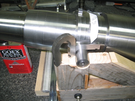

The tube is supported by the mock-up to see if there is really enough room under the breech so that elevation gear will fit along with the transoms and rear carriage lifting camshaft.
The final mock-up shows where the trunnions fit; a separate yoke showing wedge slot and female dovetail.  The can is included for scale.  The tube weight is about 100 lbs.

What's the bore diameter?  (I missed the powder can!)
I am envious of your CLEAN shop (compared to mine)!
Re: Peek at the Design Process of Our 7" Treble-Banded Brooke Rifle
« Reply #3 on: November 18, 2007, 03:35:12 AM »
     We can't wait until this big rifle is complete either, Ex 49er!  It's been three full years on this one already, if you count all the various research efforts and you must.  Glad you like it!
     Tim,  I knew your 4.5" mortar was a heavy one after you fired that first shot this past July 8th, because of the way it shook the ground!  We are envious of all that cannon making material you have; if we had just 1/3rd of the raw material you have stashed in your shop, we wouldn't have to buy any for 5 years.  The bore diameter of the Brooke Rifle is 1.1668" and what is far more important, the bore size is constant within +/- .0001" all the way up the bore.  We really sweat the reaming process!!  It is terrifically important to accuracy.
     Ah yes, the Powder CAN.  It will appear, as if by magic, later today.  I just hope I can match Mike's artistry in metal with some of my own, in wood.  Time will tell.

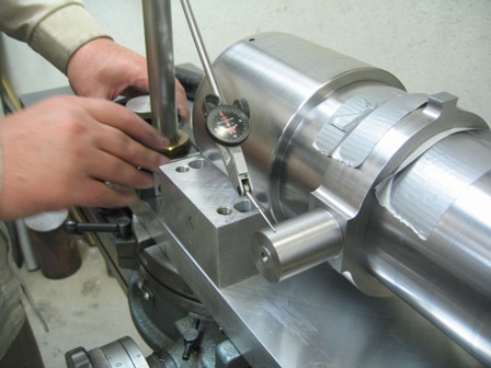

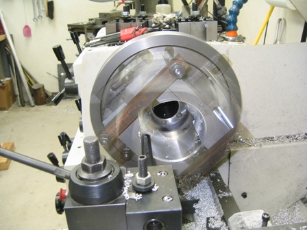

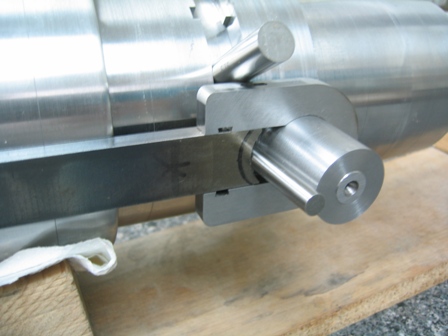

This post is in response to a question from Double D who wrote,"Could you post additional pictures of the trunnion detail.  I'm not picking up how that works from the pictures you posted so far."
     It would be almost impossible to explain this "stronger than cast" trunnion-band, yoke and strap from text alone.  From what we know about Confederate foundry methods and practices, we can estimate that this system cost the Tredegar Foundry in Richmond, VA between 3 and 4 weeks of parts fabrication and installation time.  CSN Commander Brooke must have really thought this system was stronger, or he would not have cost the foundry this precious time on each of three of these monster, "Ironclad Killers".  Basically, Brooke's system consists of a forged and machined wrought-iron "Trunnion-Band" with trunnions, sight boss and rearward projections which key into the second layer of reinforcing bands at the tube's top.  Encircling the trunnions adjacent to the band are the "Yokes" which have slots for large wedges and dovetail keys which combine to attach the ends of the 2" x 6" x 16 ft. long, wrought-iron, "Breech Strap" to the trunnions.
Regards,
Mike and Tracy
With a Criterion Boring Head and boring bar in the mill, we machine a .629"  radius on each Strap end.  Low RPM and lots of high sulfur cutting oil help to get a smooth surface.
Because the Strap ends are not perfectly equal in length, we measure the gaps to know where to machine the opposite side end radius.
We eliminated the trunnion-band/reinforce-face gap by grinding the band I.D. a bit, then cut the last Breech Strap end radius so that each radius/trunnion surface has a .020" gap.  We have no 75 deg. dovetail cutter, so those on the yokes had to be hand filed; this method will be shown later when we do those on the Strap ends.
Lots of draw filing and polishing to be done and some straightening of the strap which was twisted slightly during the  back-lot forging session to form the big cascable slot radius.  Our old gunsmith's barreled-action wrench, a 40 lb. brute, worked like a charm!
Hope these pics show and help explain how these parts are made and fit together.

The Clamping blocks are bored on the engine lathe to over 6" I.D.  The cut is almost 6" long at .100" per pass, depth of cut.
The thick tooling plate is bolted to the rotary table and the lower reinforce clamping block is bolted to it.
The imbalance of this unorthodox rig is evident here.  See how far out the muzzle has to be in order to machine the cascable Breech Strap slot bottom to the correct radial distance from the center of rotation.
A test indicator is used to make the trunnions parallel to the tooling plate, so the Breech Strap slot will be machined parallel to them.

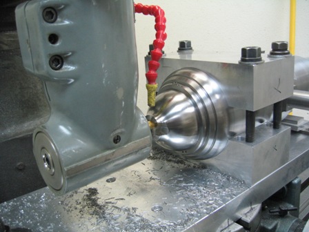

The Rotary Table swings the tube away from engagement with the horizontal end mill in the right angle milling head.
We had to place 30 lbs. of barbell weights on the end of the tooling plate to balance the whole fixture and tube set-up.
The radiused Breech Strap slot takes shape.  Ten passes of .033" each are required for a 1/6 scale depth of .333".  Full size was 2.0"  The width is machined to 1.000".
    We have studied the original thoroughly and noting the parallel sides of the Breech Strap slot, (NO DRAFT), we know that they do NOT lend themselves toward a pattern feature and they certainly didn't have any horizontal milling heads for a slotting operation as we did.  So, how was the slot made?  Would you believe hacksaws, files, hammers and chisels?  That's right, there was a huge amount of hand tool work accomplished on these seacoast and naval tubes.  FYI

This is our new bending fixture and Breech Strap forming dies.  We machined all the parts including the welding bevels and had our local welder/blacksmith weld all 120 lbs of steel.
Shown here is the alignment of the Strap in the dies before forming.  We did this 5 or 6 times on paper before getting to the point shown.  The steel formed easily and since 1018 has so little "spring-back" after forming, we only had a single degree of over-bend designed into the dies.  They and the fixture worked great!
The strap is completely bent in all the correct places, and with a little file fitting on the large radius, slipped into the cascable slot easily.
The Strap twisted a little bit as the large radius was hammer forged in our 500,000 BTU back-lot furnace, so we employed our old gunsmith's 40 lb. barreled-action wrench and Voila!,  it was straight.
Draw-filing the edges and sides of the Breech Strap came next, followed by stoning to 240 grit and sanding to 320 grit.
