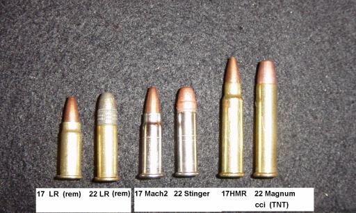

17 HMR - 17 HM2 – 17 Short….. 14 Short – 17 Short

I did not vote, but would it not be like the .22 LR and the .22 Short.  Shoot-able in the same chamber.  The Mach II is a .22LR case necked down to .17, so I would think the .17 Short would be the .22 Short case necked down.  Therefore it would shoot from .17 Mach II single shot, or bolt guns.
So you would not purchase a gun just for it, like nobody buys a gun just for .22 shorts.  At least I don't know anybody that has.

The 17M2 is actually a necked down .22 Stinger case, it's .10" longer than a .22 Lr. The 17Lr became the 17M2, there's also a 17 Aguila. ;)

Tim:  I did not know that CCI .22 Stingers were not the same length as LRs.  I've been shooting them for years with my Remington Pump .22.  It's chambered for .22 S, L, LR, and have had no problems.
But the question remains. Can't the .17 short be shot through the Mach II guns?  Same diameter case and bullet, just a shorter case.

I'm sure it could, just as the 17 Aguila can be used in the 17M2. ;)
I believe it can and it has been done but I would not expect great accuracy results from doing so. So far the testing with these 17 Shorts shooting low velocity subsonic has been difficult as I understand it due to the bullet not opening up at the lower velocity.

I don't see how a .17 short could be used in a .17 HM2 chamber since the tip of the bullet would barely be past the shoulder of the HM2 chamber, there is nothing to guide the bullet into the bore. I'm sure it would fire but no telling where the bullet would go and what damage it might do to the rifle when the short case blows out straight. It is not at all like firing .22 shorts from a longrifle chamber where bullets and chamber are all straight and the same diameter. It would be more akin to firing a .221 fireball cartridge from a .223 rifle. I would be afeerd, very afeerd!!   ::)
  I didn't get on in time to vote but I would have voted "dumb idea". We already have a confusing array of cartridges. There certainly would be people trying to fire it from .17 HM2 and even .17 HMR chambers and at best I don't see where it could do anything that is not already being done better by the .22 short and that is not a very popular cartridge even though it can be fired from the common longrifle chamber.

Just to let you know I voted to consider a purchase but since have changed my mind and would have voted to purchase one if the performance was good. Also I would have like to have seen the .17 Aquila pictured in the line-up of .17 rimfire (and the .14) shells. I shoot .17 Aqulia's out of my .17 Mach2 but would not attempt to shoot them out of my .17 HMR. Thanks....<><....:)

So, is it ok to shoot .22 stingers in a regular .22 long rifle chamber?  I also never knew there was a difference.  I have never shot them either, but was thinking about it to add some zip to my .22.

They should work in any but a match chamber, see the note at the bottom of the page. ;)
