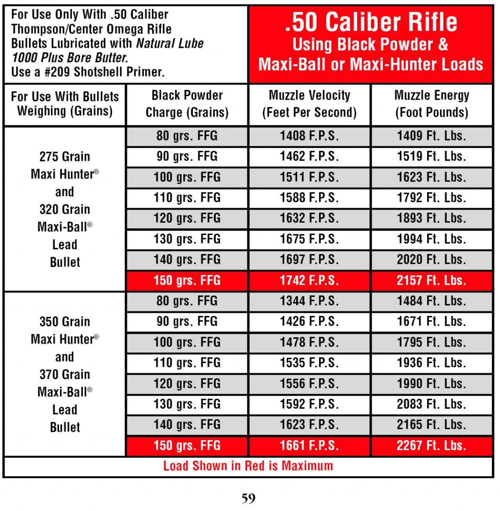

Straight from T/C:
OMEGA™ GENERAL SPECIFICATIONS:
CALIBER: .50 Caliber
IGNITION: 209 Shotgun Primer (sealed pivoting breech)
BARREL: 28" w/Quick Load Accurizer™ Muzzle System
RIFLING TWIST: 1 in 28" Twist for sabots and conical bullets
OVERALL LENGTH: 42"
WEIGHT: 7 lbs. (approximately)
SIGHTS: Adjustable metal rear sight with Fiber Optic inserts; metal ramp front sight with Fiber Optics.
TRIM: Sling Swivel Studs
STOCK: Composite or Laminated Buttstock and Forend.
EXTRA FEATURES: Drilled and tapped for scope mounts
LOADING: Accepts magnum charges of up to 150 grains of FFG black powder or Pyrodex® equivalent (or 3 of the 50 Grain, 50 Caliber Pyrodex® Pellets).
If you recorded who you talked to, you should call back and report them to their manager if they really told you that.  All of their inlines are rated to 150 grains.

Re: T/C shooters READ THIS
« Reply #19 on: October 21, 2007, 03:53:32 PM »
The last information I have is that T/C still does not allow more than 100 gr of loose Triple Seven except in pellets.
That's not what their owner's manuals show, they show loose powder loads to 150gr.
As Keith said, you must have talked to someone that was misinformed, as he also said, the Omega has 150gr loads listed in the manual, as does Triumph, Black Diamond and Black Mtn.
http://www.tcarms.com/assets/manuals/current/Omega_Muzzleloader_Manual.pdf
http://www.tcarms.com/assets/manuals/current/TC_Triumph_Manual.pdf
http://www.tcarms.com/assets/manuals/current/Black_Diamond_Manual.pdf
http://www.tcarms.com/assets/manuals/noncurrent/Black_Mountain_Magnum_Loads.pdf
Here's some of the Omega data if you can't download the manuals...

Well, it also says to duplicate black powder loads, reduce by 15%, so you just have to use your own judgement. ;)
Triple Seven is a high energy product designed to provide the muzzleloading hunter with higher velocities when used in the same VOLUME as black powder. To duplicate a black powder load velocity using Triple Seven, you must decrease the powder charge by 15%.
http://www.hodgdon.com/tripleseven/loadnote.php
If you choose to go against the powder manufacturers recomendations then you should have information from the gun maker showing it's ok. You don't have that with T/C yet. The Thompson Manual you linked to does not mention Triple Seven yet. They say to use the powder maker's recomendations and Hodgdon says 100 grains. With CVA for example they list 150 grain max for pellets but only 100 for loose powder IIRC. Knight has a 150 Pellet max and 150 for loose and specifically mentions Triple Seven as an approved powder (except the Tk-2000 which has a max of 120 for Pyro/BP and 100 for Triple Seven). I have no idea what other gun makers allow but I would not exceed their powder maximums. I only shoot 90 grains of powder anyway so it's no big deal for me but someone reading your posts might think it's ok to use something that isn't yet allowed by the manufacturer, either of the powder or the gun. I think it's a bit irresponsible to be promoting loads heavier than the manufacturer recomends. Unless T/C says it's ok your on your own.

The manual that came with my "Magnum" Encore is nearly useless when it comes to loads.  It has all kinds of stuff on T/C Break-o-Way sabots and all kinds of data on the pistol.    Would you believe that it does not have loading data for Pyrodex granular and Mag Express sabots for the rifle?
