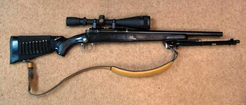

I've got 2 of them (7mm-08 wife,, 300 Win Mag mine),,,both painted black fusion,,the 300 win mag knocked the dog doo-doo out of my bad shoulder so I put a 2lb soft diving weight in the stock and a limbsaver recoil pad on.  Filled the for-end with epoxy, bedded the recoli lug,,put on another swivel for a bi-pod,,bought a Kartel cheekpiece, EGW 25 MOA mounts,,new Simmons 4-21X42 Master Pro series Mil Dot Target turret scope on both of them.  First day out with rifle, JB bore pasted the crap out of the barrel during break-in and sighted in at 200 yds. At the end of the day (wife's first day shooting high power rifle) she was popping the 12" gong at 585 yards after I dialed the elevation in, consistently with 140 grain FACTORY Federal Fusion ammunition with the 7mm-08.  The 2 rifles are heavie, mine a lot (needed) more solid forend (needed) and don't look like tupperware (needed)!! Look as good as any high end tactical guns out there and both will propably outshoot most of them.  My 300 is shooting about an inch at 200 yards with Factory Federal Fusion 180 grain.  The Fusion is the most accurate factory hunting ammunition I have ever shot.  Getting ready to buy another one in 308 just to make a dedicated F-class T/R rifle out of,,,,now that one will REALLY be pimped out!!!
Offline wsmitty01
  • Posts: 60
Re: Pimp my Stevens 200
« Reply #14 on: October 11, 2007, 12:29:04 PM »
Here are my 2 Stevens 200.
