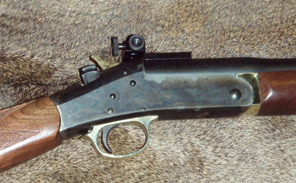

Ok, I'm to the check the fit stage, most of the rough polishing and some finish polishing done, wanted to check the fit to see how far into the frame it fits, still need to do a little more finishing where the trigger guard meets the frame and the inside of the trigger guard. I was able to heat the spacer on the electric kitchen stove burner and with the added help of a propane torch, got it red hot and straightened it out perfect. After cleaning it up on the belt sander, I used 320 wet/dry with Kroil, then 600 on both pieces, then some finish polishing with a dremel felt polisher and Flitz. Not much more and she'll be done. I'm a bit disappointed in the fit at the rear of the trigger guard, Tom took too much metal off there so it leaves a gap between the finial and the frame. :( Gotta do the trigger job again, it's back up to 4lbs-12oz. :-\

They sure look good though, Tim.
I've grown to expect a little work when it comes to anything dealing with these Handi's.  For the $ that those spacers and guards lightened our pockets - a little elbow grease is a fair trade-off.  :D
RIP ~ Teeny: b.10/27/66 - d.07/03/07

Looking good Tim . Has anybody ever found any of the brass barrel bands that work? Even if they were for another gun that could be made to work on Handi's with bbl bands? Kurt

Looks good Tim.

Looking great Tim,...
Made another trip to the post office at noon and I now have the pieces in hand.  I know what I'll be doing this weekend.
Hope the Wife dose't mind. :)
Tim my spacer was void of the custom offset that yours had.  I guess you had to pay more or know someone to get a fancy one like that. :D

Yeah, that was a bit of a disappointment, but not hard to fix. The bigger disappointment is the fit at the rear of the trigger guard, I hope they aren't all like that. I sent Tom an email with a pic of the gap, he hasn't replied yet, I may have to call him if he doesn't, but I don't like to bother him if he's working making more parts!! ;D

Yes, for someone that's not a DIYer, the mis-shaped spacer would have been bad news. But anyone that installed the TG had better be pretty handy with tools to do the trigger job, unless they have it done by a smith. ;)
I used the included slave pin to install the trigger, it could use a little more taper on the ends to allow it to align better, but it worked, but so does a piece of 3/16" dowel. :D

Metal finish work isn't hard with some power tools, just time consuming, that's about a 4. The holes in the TG are a little on the tight side, a pin wouldn't just slide in, I had to clean them up a bit with a drill bit by hand. Other than that, it fit pretty good. The spacer is on the thick side, so it will be tight, it's also rough so it can be thinned down and finished and won't need much if any shimming, screw holes are perfect.
The first trigger job is about a 7 or 8, but once you have one under your belt, they become a 3 or 4. :D The anxiety of the first trigger job is the biggest hurdle, actually doing it isn't all that hard. Of course some people just aren't inclined to be the DIY type, so it's harder, plus if they aren't DIYers, they likely don't have the tools that go along with it. :-\
