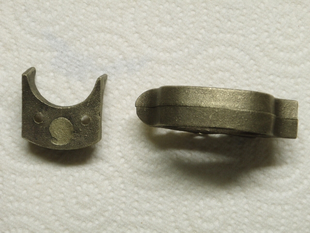

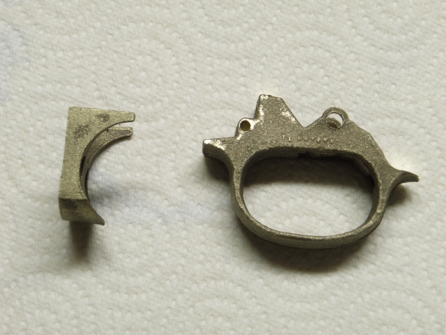

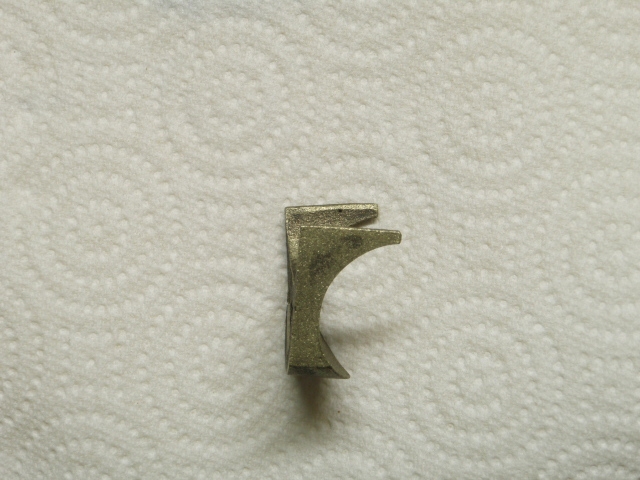

Got em, there's a problem with the spacer, the top rear "legs" aren't parallel, don't know if it's soft enough to bend, or I'll have to heat it, gonna ask Tom what I should do. The trigger guard looks pretty good, although it won't fit the frame very close at the rear, looks like he ground too much off.
Here are some pics...

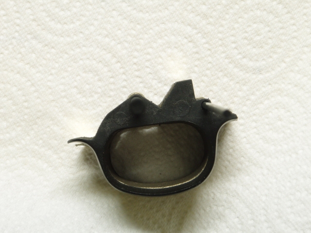

This is a comparison of the OEM plastic guard laying on top of the brass guard with transfer punches thru the pin holes, they line up perfect.

Maybe I should be much more happy with mine they look a little better than yours but I don't have one tore apart to compare the hole line up. Kurt

I don't think I would be happy with this guys products and all of the trouble yall had to go through. Maybe others will be better. I would stick with the plastic.

I agree it does not look like very good craftsman ship to me. Dale :'( ::)

I think I could work with the trigger guard. Clean it up a little and spray paint it or use something like the truck bed liner paint and not clean it up any. It should be ok as far as that goes. Now the forearm spacer. I don't think anything can be done that hasn't been said. I would stick with the plastic and maybe paint it.

How about the metal composition; after finishing and polish is the alloy able to take blueing? Or maybe aluminum black or some other chemical coloring method? ???

I don't know why you would want to paint them...for me I bought the brass so that I could make them shine and I see no reason they should not polish fine . I have ordered a set of the steel ones that will probly be painted or even blued on future project. Kurt

Tim I got a steel/cast spacer that came off a 19 0 something oak forearm for a old H&R scatter gun that I use on my USH barrel and it is virtually identical to the brass spacer so I kind of wonder if thats not what his mold is modeled from. I also wonder is the offset on your spacer caused by stress when it comes out of the mold ,maybe it will straighten when mounted to the wood? Kurt

As Kurt said, why in the world would I want to paint it? ::) I ordered brass so it could be polished to match the hammer on my 45-120 BC, brass work just takes a little work, although with power tools, it's a lot faster than with hand tools. I'll go at it with the belt sander first to remove the mold lines and flash, then on to the buffing wheel and dremel.
I sent Tom a pic of the spacer, he agreed that it should be heated to fix it, so that's what I'll do, if it breaks, he'll replace it.....eventually, he won't be making them for a while, if he does any more. :'(

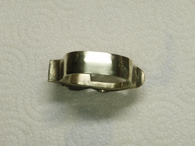

Here's what 20 minutes with a dremel and belt sander has done so far, I spent a couple minutes polishing with a dremel felt buffer and jeweler's rouge to show the potential finish, but it needs another hour or so total work, more than likely. ;)
Before
Now

WOW ;D
I knew they would shine up, but seeing is beliving!
Thanks Tim ;)
