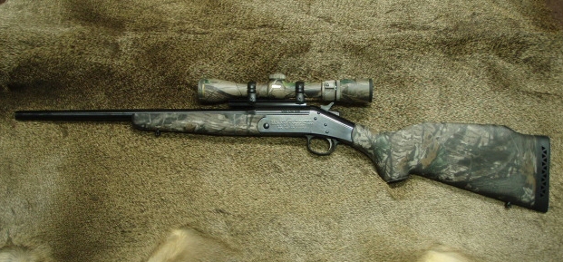

I recently bought a 243 Superlight barrel from Holahead, fitted it to an NP frame and put the synthetic monte carlo stock set that I just got from H&R on it, mounted a 2-7x32 Nikon Prostaff in lapped super low Burris rings, it's all ready to play now!! I hope the Mossy Oak stock and Realtree scope doesn't clash!!! :o ;D

Nice looking rig Tim , almost what my daughter's 22 mag tree rat gun looks like except hers has a black scope and low comb stock , now to just find a load it likes .  :o

That is a perfect example of the one handi that can do it all if it shoots well.  Light, camo, weatherproof stocks, versatile scope, near and far, varmints to deer...good job.  Now get it to shoot.  I shoot the vmax bullets in my 243 Vanguard...
