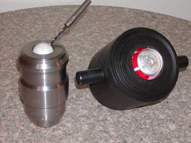

Looks nice, I'm jealous, I have 2 mortar tubes and no bases.https://www.gboreloaded.com/mhp/images/mongo223/scgbm.jpg
click for full size

Those are nice tubes. I built this carriage sight unseen for the barrel I should get here in few days. I had all the dimensions for the tube and kinda had to start from the ground up. But since this is not going to be a rear trunion mount I think this sled will work. All I will have to finish is the placement for the trunion bracket and the trunion caps. Either that or I have put the cart before the horse and and spent alot of time on a sled that may be all wrong. We shall see soon.....
