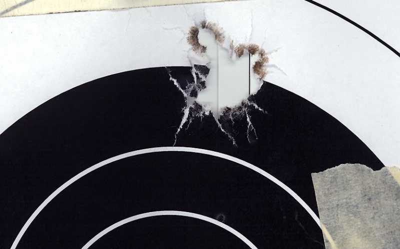

I loaded up some 540 grain paper patched bullets and went to the range.
The bullets came from Buffalo Arms and I patched with egg white per my gunsmith.
The patch material was from buffalo Arms - 100 per-cent cotton rag .023 thick
55 grains weighed of Pyrodex select
.03 over powder
.09 lube disc
.06 over lube wad
Five breaths of the blow tube tween shots.
Pedersoli 45-70 34" barrel
Malcom 3/4" 17" long scope - 3x.
The best of two 5 shot 104 yard groups is shown below:

I have heard of using egg white and water mixed before, but my gunsmith said to use just egg white.  You can do a bunch with just one egg.  It seemed easier to roll the patch on and was stickier than anything else I've tried.  It was easy to use

The rifle was bench rested and pretty well locked in place.  I am pleased with how accurate the rifle is though.
I am a firm believer that these rifles and the paper patch bullet can be an extremely accurate combination.  I am also sold on egg white as a paper patch ingredient. The paper doesn't tear as easily and it dries hard gluing the paper together.
I also believe that Swiss powder is not necessary in order to have an accurate rifle.  I shoot 1" to 1/1/2" groups too often with Pyrodex select (from a locked benched position) to believe Swiss is a necessity.
And a blow tube does aid accuracy - though I'm not fond of it.
I am new to this type of shooting and have a lot more to learn.  The experts at Greybeard that have given me advice sure have saved me a lot of time and trouble.  Thank you.

I got my bullets from Buffalo Arms.  They are marked  (.45 Cal   540 grain cup base   Diameter .450   Tapered paper patch).  I measured them at .452 plain and .457 with the paper attached.
As far as the paper sticking to the bullet, I don't know, but it shoots good so I don't worry about it.
My gunsmith uses cardboard from the cereal boxes for his 30-30 with egg white and gets great groups.  That's where I learned about using egg white.
I do know that a blow tube is necessary as is a good bell on the case so the paper won't tear when the bullet is seated.
I do not know if this will work in every rifle or if this is just rifle specific, but it has shot well for me both times I have used it.  May it also do well for you.

I was out of 2f and there was no black powder in my area for sale, so I went to Sportsmans and bought a jar of Pyrodex select just so I could shoot something until someone brought in some more 2f.  I measured 70 grains - volume - pyrodex select, and then weighed it.  It came very close to 55 grains weight.  So in trying for better accuracy, I just weigh charges to 55 grains then drop them through a drop tube and the case is filed very closely to the top of the case.  I compress the snot outta it, and finish loading.
I was trying different loads from 55 to 70 grains volume and this load worked the best for me using a 457677 lyman mold with 20-1 lead/tin mix
