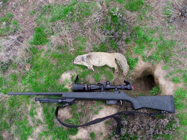

I also have the cz 527 .204 vamint Kevlar, this stock is free floated and has aluminum bedding, in theory it should shoot better, plus it just looks way cool! shoots great with crappy HSM ammo here are a couple of 3 shot groups at 100 yds
dead squirrel at 309 yards
