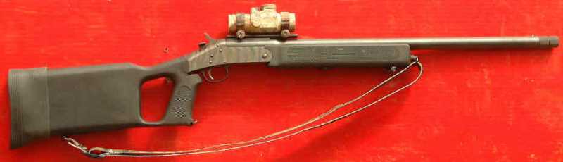

As far as sights, I understand that H&R will install iron sights on some barrels that do not come standard with them. Perhaps they could put on a set of "Tracker" sights for you. That would be a nice setup, and probably what I should have done with mine when I found it shot far from the point of aim. What I ended up doing was to spend lots of money on a custom-machined, silver soldered mount, a reblue and a red dot. I like it a lot, but probably wouldn't do it again if I could get the Tracker sights.
Here's pics:

If you already have the turkey barrel with the screw choke then the cheapest way to go is to see if it can be D&T'd.  That will have to be determined by your gunsmith.  Some will and some won't.  Just depends on how thick your chamber on the barrel is.  Otherwise its silver solder.  Some guys here have had success with JB weld and done it themselves.  gimphunter has probably got the cleanest set up I have seen.  Like he said, that's not a cheap fix.
