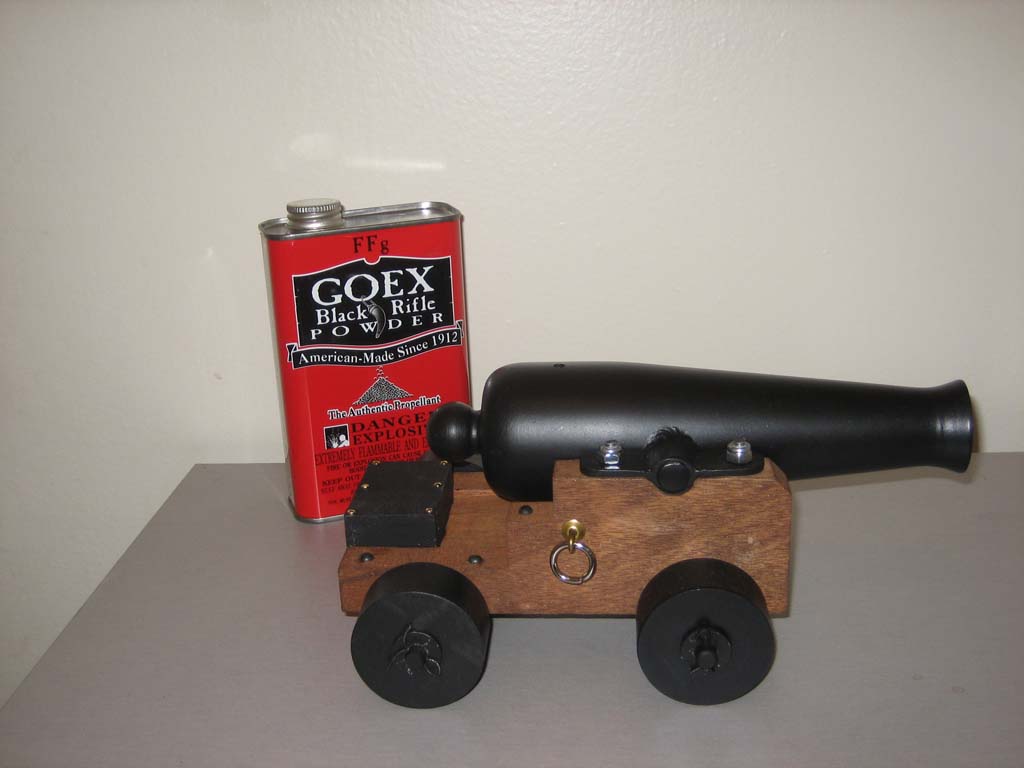

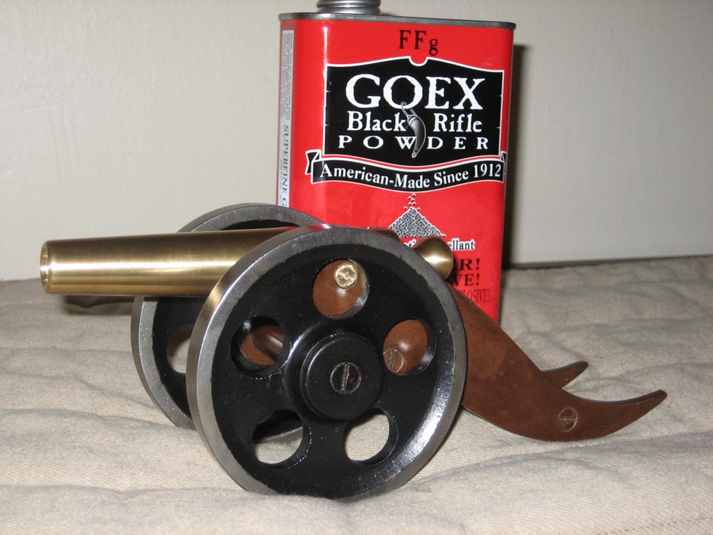

« Reply #10 on: January 20, 2007, 08:10:52 AM »
Firebuckeye,
anything larger in caliber would considered a micro cannon here on this forum plenty or our sponsers - builder can provide what you desire... I have enclosed a few photo's of some work done for me...
Ed
