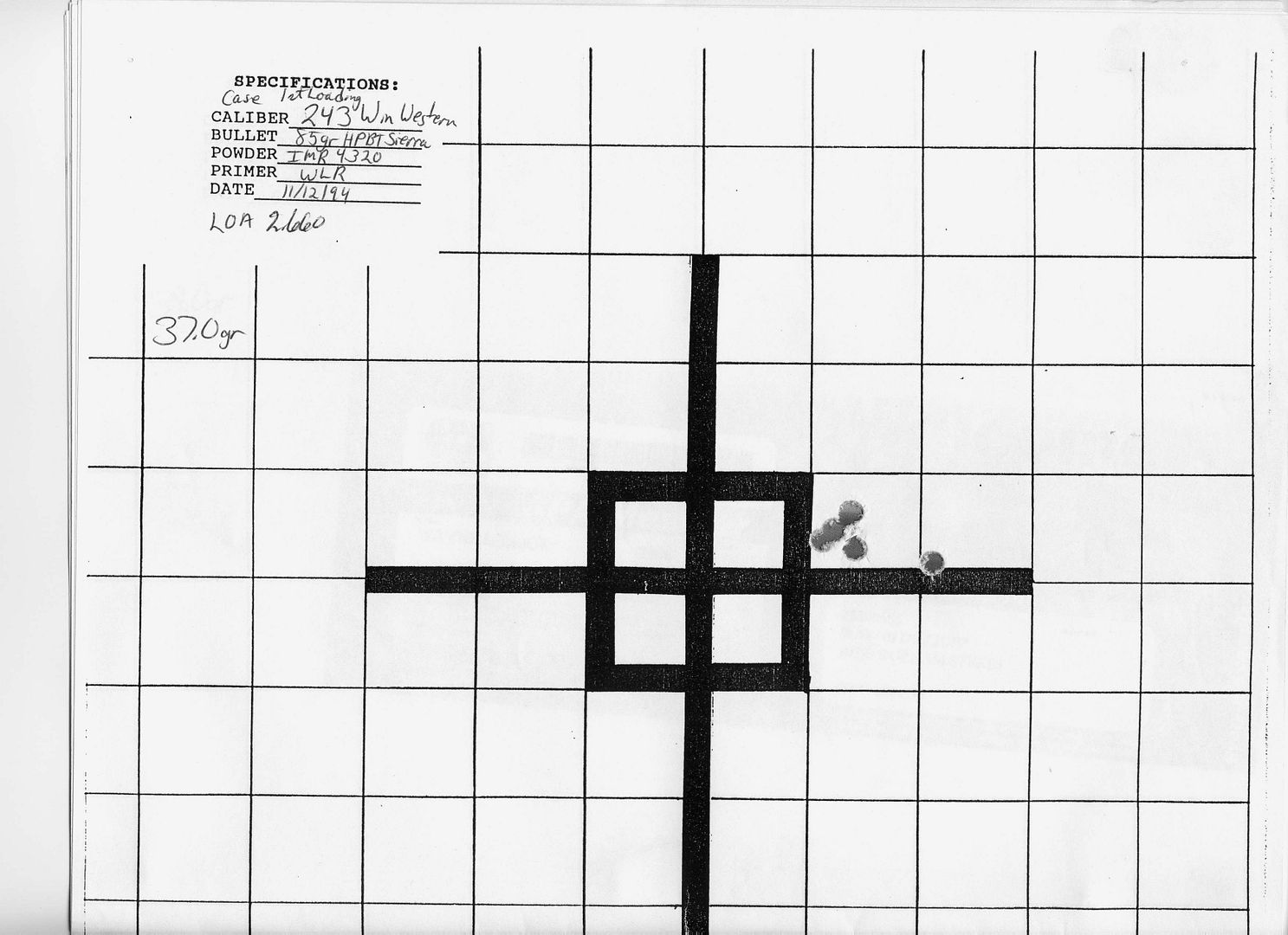

« Reply #15 on: January 06, 2007, 03:52:05 PM »
IMR4350 with 85 gr HPBT
IMR 4320 with 85 gr HPBT
