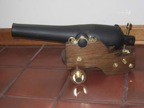

I can personally and Highly recommend Mr. R. Berke George “Ye Old Cannon Maker” in Connecticut http://www.dicannonworks.com/ and Len who makes their carriages as very dedicated friendly people that are putting out an extremely high quality product. Berke has been building cannons of all sizes for 45+ years. Their 10 gauge Signal/Salute Cannons are the best on the market. Yes more pricey than the WRAÂ’s but on wooden carriages they are worth the extra.  :agree:
See the picture of the 1/7 Scale Dahlgren Marsilly Carriage that Len just specially built for me. The barrel is from Paul Barnett of South Bend Replicas.  :grin:

Cpt Ed -
Looks like a SOLID cannon (as Dahlgrens do).  Appears you're building a quality collection too.
Are those 12" floor tile under it?

The tiles are probably less than 12” under the Dahlgren. The picture was taken by Len the carriage builder, prior to shipping the completed cannon to me here in Florida. The barrel is 19” in length, with a 1" bore.
