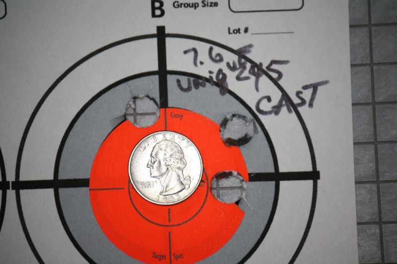

Here is 245 Cast, 7.6 grains of Unique, crimped. Just under 1.5" at 50 yards.
This was with a 1.3X power scope. I am sure these loads would do a little better with a higher power scope. Any rate, it is in the kill zone at 100 yards.
