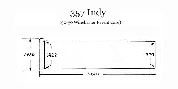

I love the look of the 358 Craig.
The 357 Indy should have about 19% more case capacity than a 357 Maxi.

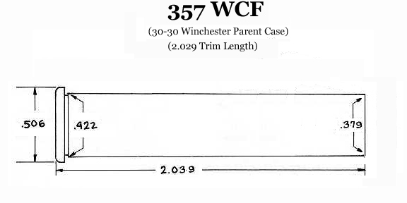

I also drew up a 357 WCF, a tapered full length 30-30 case. It would be a 38-55 but using 357 mag bullets.
Again, it is all in the pursuit of a simple H&R 357 Mag rechamber, and pressures not exceeding 357 Mag, so can be done on a SB1 frame...hopefully.

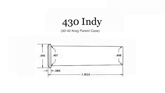

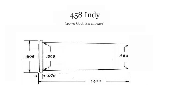

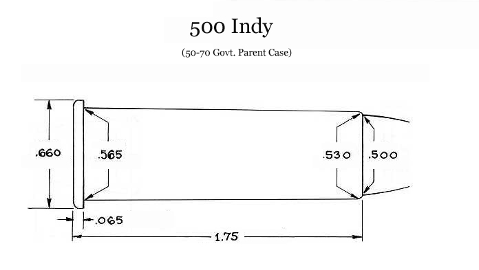

Just for fun I drew up a few more "Indys". The 430 and 500 are simple H&R rechambers. The 458 might have to be a stub.
Enjoy.
