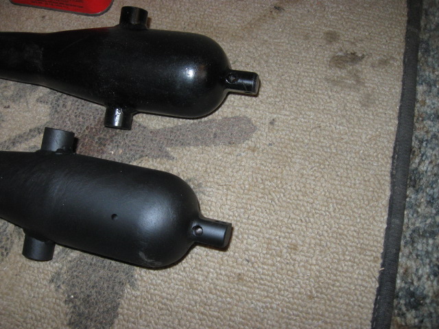

Perhaps this is a better shot of the profile @ the muzzle- shot at a 90 degree angle rather than oblique.

What's wrong with that?

« Reply #33 on: May 28, 2010, 05:21:26 PM »
Nothing wrong, just exploring the different interpretations  of Muzzle swells on Dahlgren's.

No expert here, but I think it depends what gun you are scaling.  Am I wrong?

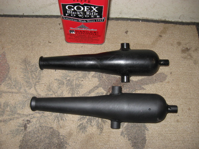

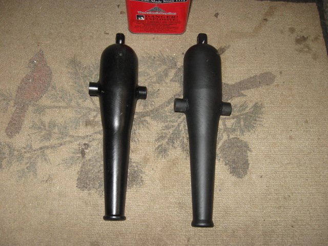

OK here we go , 1st & 2nd tries ,
The newer version is in the flat , proportions are better .
I changed the radius from .062" to .187"
Changed the muzzle flare from 45 deg. to 20 deg.
To use your analogy about eye candy Double D , I still think her butt looks big .  Armorer77

« Reply #36 on: June 02, 2010, 11:02:02 AM »
That second version looks sweet!!!  Great Job!

« Reply #37 on: June 02, 2010, 01:28:15 PM »
Really nice gun you have there sir.  The proportions do look better and trunnion placement too.  Congratulations, may you sell many!

« Reply #38 on: June 02, 2010, 02:48:32 PM »
Very nice Ed, the second version is a winner!!

« Reply #39 on: June 02, 2010, 03:23:38 PM »
It looks to me that the length of the largest diameter is still a little too long compared to this:
I think you need to radius the transition from sharp taper to cylinder more than you did.

« Reply #40 on: June 02, 2010, 10:05:54 PM »
Ed, the second one is pretty darn nice! Good Job!

« Reply #41 on: June 04, 2010, 03:10:25 PM »
That is what it should look like ,;D Good work .
