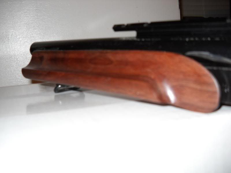

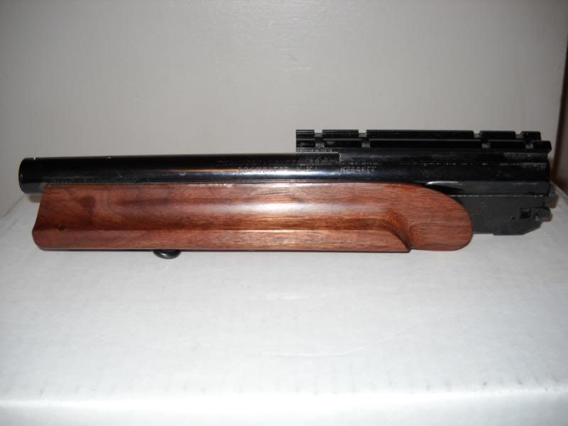

I made up a couple for my Contender for the same reason - nothin' sits in the bags worse than a small T/C forearm for 10" barrels. The Rynite carbine forearm is a bit better but still tough to control in the bags. A pic below is one I made for my 10" barrels. It helped me learn to shoot the short guns from the bags and really helped tighten up groups. It's hard to develop a load when you can't shoot consistant groups! I also wanted it to be comfortable to shoot in the field. It's 2" wide and the way it's contoured makes it light and easy to hold in field positions but the flat bottom rides the bags well. Set up on the bench properly it tracks level and straight back. I made one up to fit my carbine barrels as well - just a little longer. Pretty easy to make, mine were from scraps left over from stock blanks. Most of the work was done on a mill with a 3/4" rounded end mill run at high speed.  I made stainless inserts for the sling swivel and attachment screw, which also acts as a pillar. Glassed with Devcon, POI hasn't changed after numerous times on and off different barrels.  Now I need a couple for my Handi barrels. Happy Tinkering!

Hey Antietamgw great job. I really like the contours. It's tinkering that makes things great. I made a forend for my Rossi out of butternut with walnut stain and 3 coats of poly. reclusej
