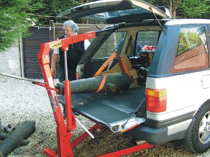

Squire R,
What's the approximate weight of your gunnades, and when you take one out to fire it, do you and your friends just muscle it in and out of the vehicle your using to transport it?
It weighs lots more than any scale I have can measure, I can move the small end sideways when it's on the floor but that's about it.
I take the engine hoist, I lift it and then move the car. Muzzle loading is an old man's sport, the muscles are still there but the joints are doubtful  ::)
