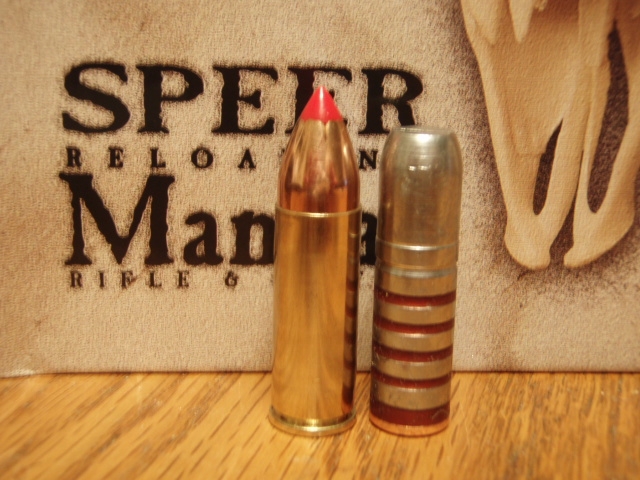

Offline dpe.ahoy
  • Posts: 3363
Re: H&R .458 SOCOM dreams
« Reply #4 on: April 08, 2009, 03:44:02 PM »
Hey Tim, looks like ya might be a bit shy on powder space when ya seat that cast bullet. ;D  Or is that for the 460 ream job? (Wink)  DP

« Reply #8 on: April 08, 2009, 05:53:38 PM »
That cast bullet is either a Ranger Rick 700gr .500" or a 720gr .459", just for comparison.  ;D

« Reply #11 on: April 08, 2009, 11:13:24 PM »
That cast bullet is either a Ranger Rick 700gr .500" or a 720gr .459", just for comparison.  ;DTim
Creative pic I must say. 8)
